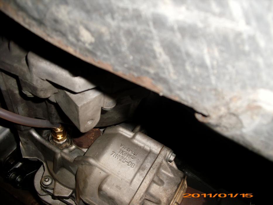

today, 01-13-2011, at the moment when slowly unfastening the magnetic plug, I saw the TC fluid coming out. Good sign, isn't it? about 100ml normal dirty gear oil came out when the car standing on 4 jacks. another 120ml oil came out when tilting to the driver side. the plug was dirty with black sludge. the internal mouth of the hole was also dirty with sludge. my finger went into the hole, feeling there was some steel components located not far from the hole so I did not use my brake oil bleeder to suck out the other oil. I went to buy a brass nipple (1/2" mpt at one side, 13/16" hex in the middle, 1/4" cmp on the other side which for a hard plastic hose at home depot. I paid about $16 for both of them. I got a bottle of mobil #1 75w-140 gear oil(294ml) and an oil pump. OK now I used a 13/16" wrench with an open side to turn the nipple into the hole, then inserted one side of a hard plastic hose into the other side of the nipple and tightened the hex nut to compress the plastic hose on the nipple. I tried to pull the hose feeling pretty tight. I pulled the other side of the hose along the transmission bottom and through the open area up to the front of the battery. cut off the extra length and held it there. connect it with the oil pump. Now I pump oil into the hose. Wow, I felt a significant pressure producing after pumping 100ml. stopped pumping and took the pump's hose out. now I saw oil level dropping down ( that proved that there are no vents inside the TC assembly.) then kept pumping more oil into the hose until it stayed at a level just above the TC. The total oil of 300ml was pumped into it. That"s it. I am done. Now I can conclude that first, the original TC system was working under a high pressure of oil + air when it is hot and works fast. second, the pressure is a crime to make the seals malfunction and oils disappear unknowingly. second, TC oil should be changed at a certain of time. That is not life time working safely.

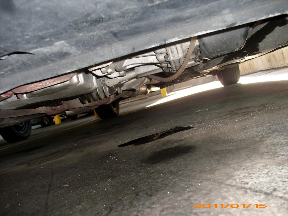

01-15-2011 yesterday I drove 25 miles on the local streets. this morning I found oil leaking. I have to find out the problems: overflowed or leaking at the compressed joints of the hose and nipple fitting.
It was the compression fitting problem that caused oil leaking. I replaced them with 1/2"x1/8" nipple and 1/8"x1/4"brb side nipple shown in the picture. Now I think it should be OK. the part of the hose was wrapped up with high temperature tape under the bottom of the car.
