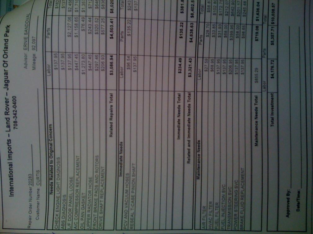

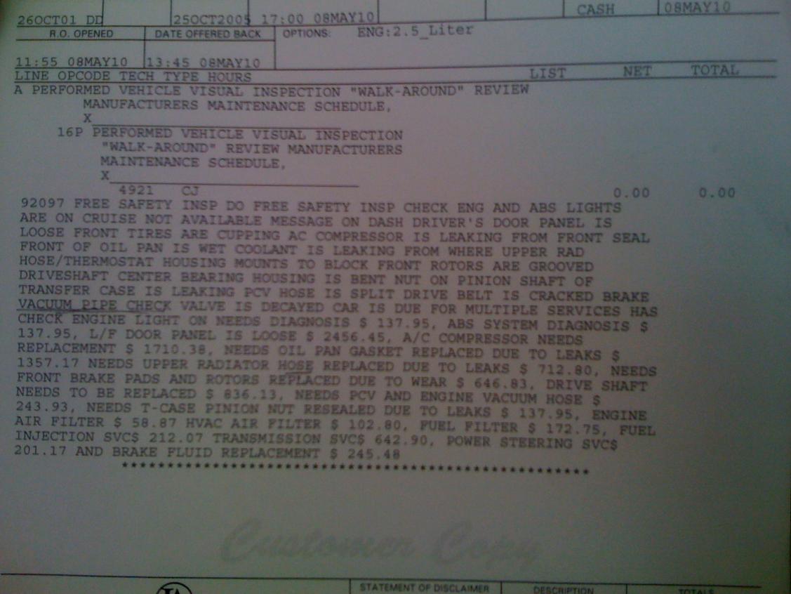

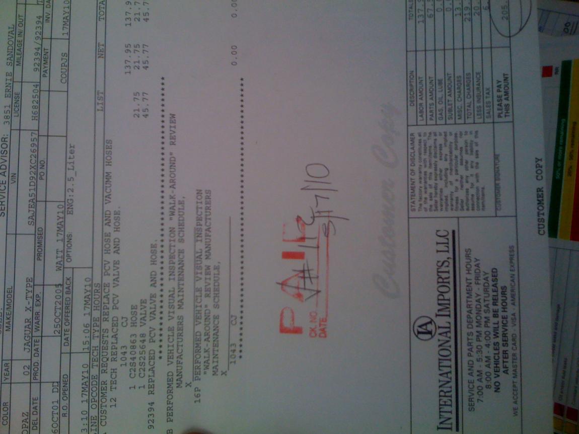

So, you don't think it's the CV joints, more like leaky O-rings?
I've bought a MAF cleanser and have cleaned it out, it was dirty, and then cleared the codes, yet the Check Engine Light returned.
If you read what I said in the first post, I mentioned that I had PVC hose and valve replaced by Jaguar, yet the problem still remains.
When I got the safety inspection, they gave me an invoice full of notes of things that I needed done, I've attached pics of what they said was wrong, in a list, in details and what they actually fixed when I clearly requested the PCV and Vacuum Hoses to be replaced.
