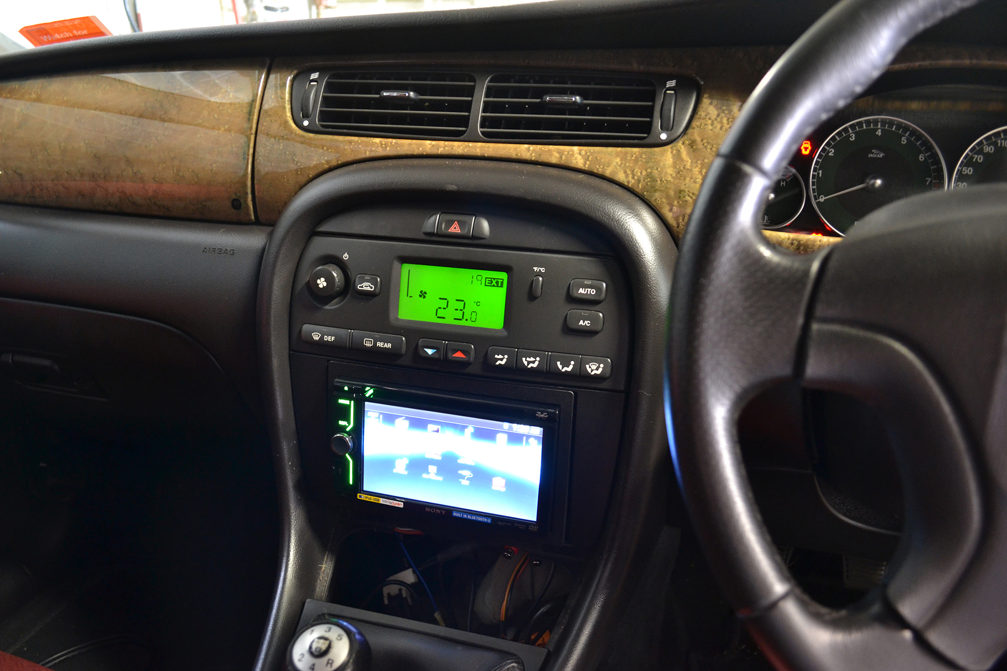

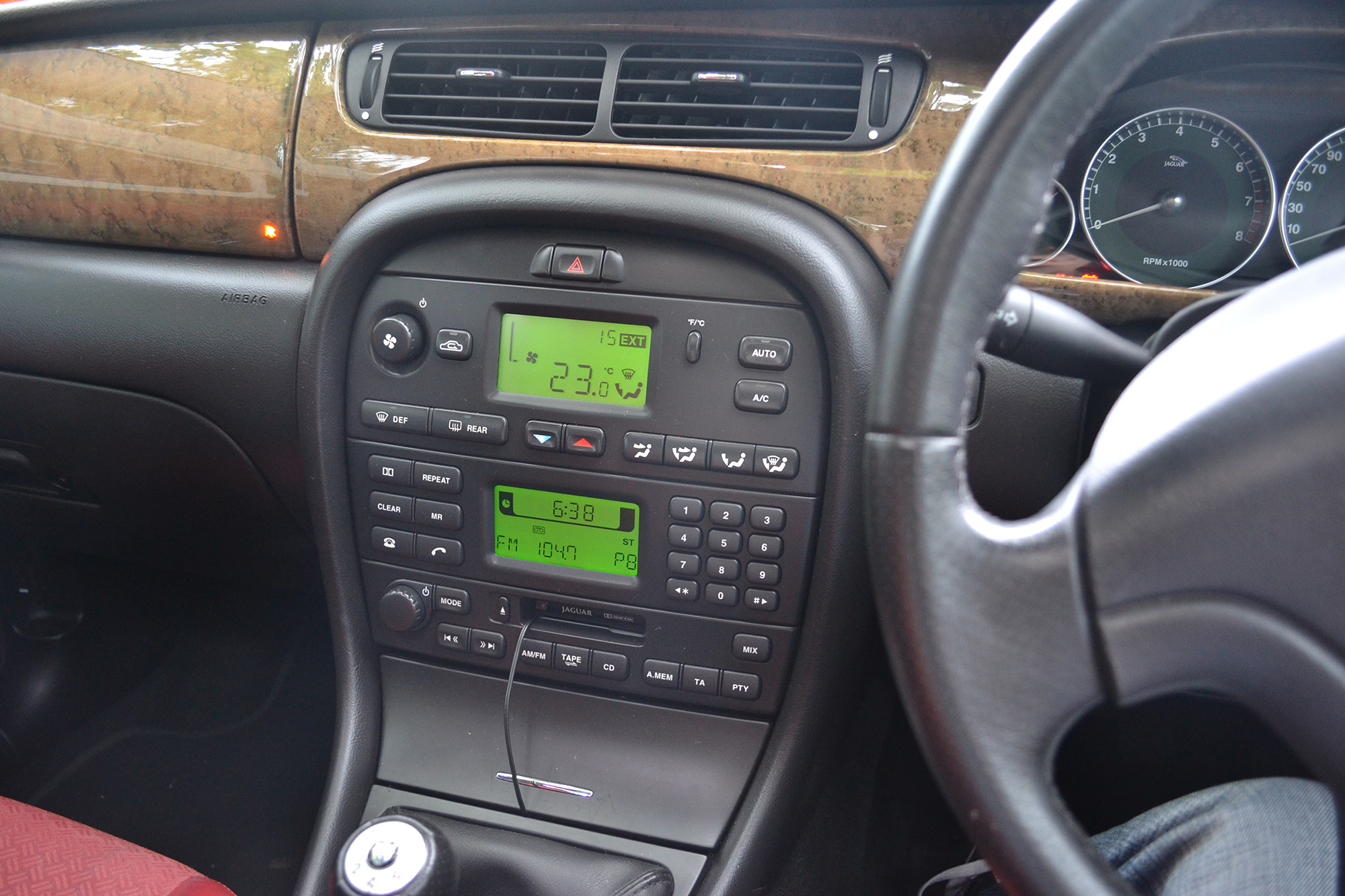

Yeah I got a little tired of the old head deck in my car. Great that it came with a 6 stacker CD player, but I haven't used CDs since 2006. So like you I also contemplated on upgrading the head deck with the navigation OEM head deck but found the cost and difficulty in doing so just too much like what Thermo said.
It was far easier and cheaper to simply buy a new head deck (touchscreen which can mirror my phone, ie Mirrorlink), buy a wire harness adapter and a facia then you're good to go. I think I did it all for about $700 AUD.
I can list all the parts out if you're interested?
Oh also take a look at my before and after photos (just in the after photo try to imagine that the ash tray is put back haha)
