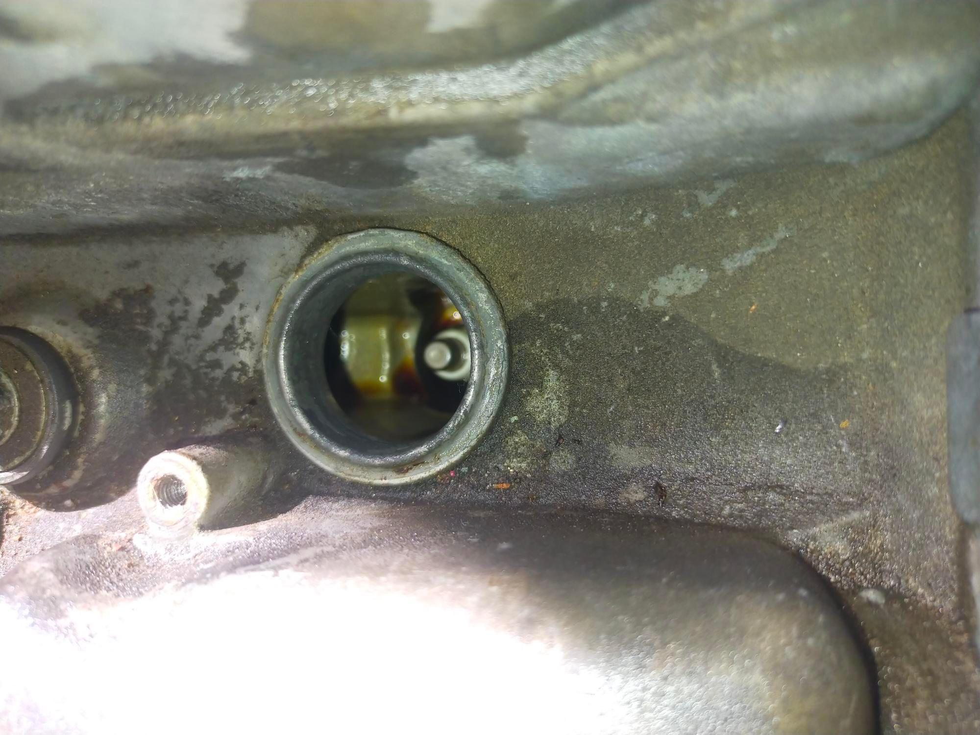

I was on a mission to get the rocker cover gaskets changed after an oil leak from my last repaire ( 2001 X type ). When i removed the ignition coils i found that the spark plug wells on the expreame right (Right hand drive car in Australia) the same side as the brake master cylinder sits, was filled with oil and the other 2 wells were dry . Whats happeneing here ????

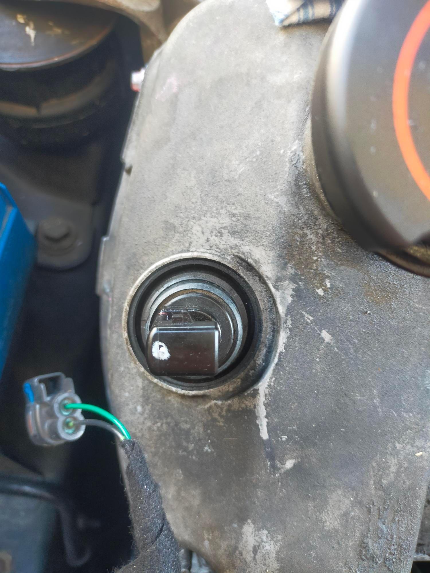

As for the VVT, i have attached the images, I w4ent to the auto part store and they have given me a reasonable alternative, that fits the hole and gives a good seal, ( one image is with the original
Thank you again
Oil inside spark plug well when i started

I think the VVT solenoid

And I learned something: Yes, this looks suspiciously like a VVT sensor... Good that you found a gasket.
