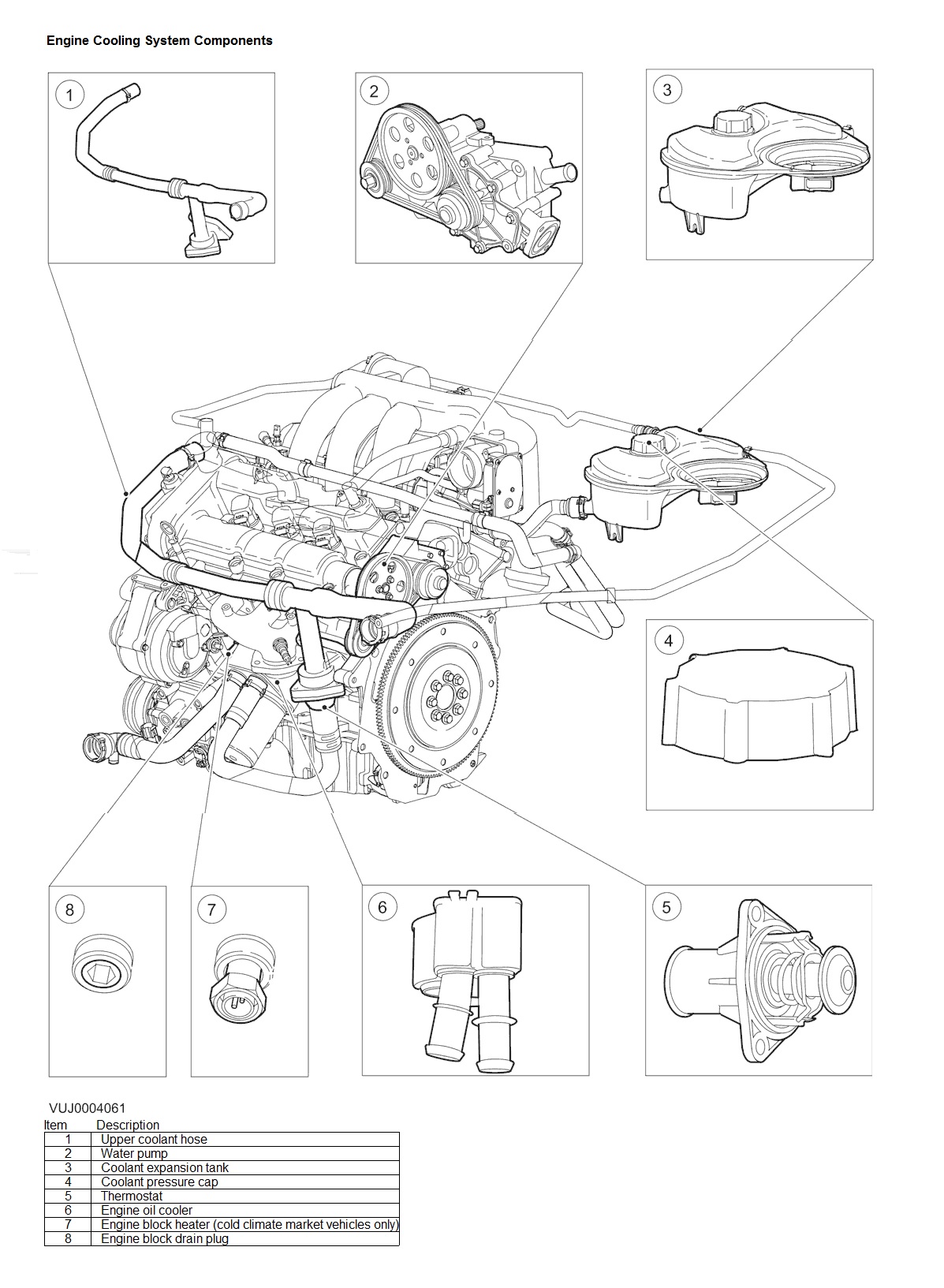

Inconvenient though it is to have the vehicle stuck ten miles from home, you did exactly the right thing not attempting to drive it any further after a coolant loss.
Jaguar temperature gauges haven't the best of reputations. The engine is usually overheated before they even move.
The sudden spike in coolant temperature and loss are probably due to nothing more that the belt tensioner disintegrating but could be:
1. split hose
2. Water Pump bearing seized (item 2)
3. the thermostat stuck (item 5)
4. Expansion Tank pressure cap failed (item 4)
You can check the water pump by simply spinning the pulley before fitting the new belt. It needs the new tensioner fitted and then refilled to check for leaks from hoses. Rather than use expensive coolant for this, water will be adequate to get you home (provided everything else checks out when the engine is started) where you can drain and refill with the correct concentration of coolant once the engine has cooled down again.

xtype3point0, like GGG said, you can probably just replace the tensioner and belt, top off some coolant and go from there till you can get in your driveway and put the finishing touches on the kitty.
As for the belt going, that can be something as simple as the pulley on the tensioner failed and seized, resulting in the pulley getting hot, failing and taking the belt with it. It could also be that the water pump seized and that caused the tensioner to be flexed too far and that lead to its failure, which then took out the belt. Spin the water pump by hand and see what you have. It will be obvious if the water pump seized. From there, replace what you need to and get the car home. The drive back will tell you if you need to replace more stuff.
Granted, the other thing to consider is to have the car towed/hauled home and then you can work on the car in your driveway and simply do all the repairs you need when you have time and have all the tools right there at the ready. But, that is also a few more dollars out of your wallet too.
