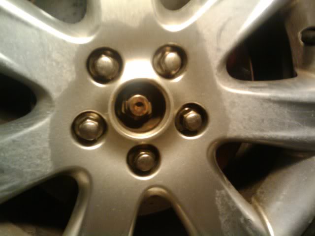

The front lugs are not breaking for me?!? Here is a pic of what I'm dealing with:
Any suggestions of what could be wrong? Oh and back ground its an 03 3.0 x-type with 195K miles on it. Runs fine The only reason I was changing the brakes is they groan when you first start driving but the groaning goes away after they warm up.

Darth, I would say that whoever rotated your tires the last time did it while the rotors were hot, which would then lead to the studs being hot. This causes them to grow a little bit. So, when you torque them to where they should be, as they cool, the stud attempts to shrink, leading to very high torque values.
As I see it, you have 2 options.
1) drive the car, do a few hard braking runs to get the rotors nice and warm. Then, immediately drive the car to a spot that you can break the lugnuts loose (ideally in your driveway).
2) break out a big 1/2" breaker bar and an impact socket (19mm). Put the socket on the lugnut, put on the breaker bar and then add a cheater. Plan on applying about 300 ft-lbs of torque to get those puppies to move. So, if you start seeing spots as you are using the breaker bar, you are getting close, brace yourself.

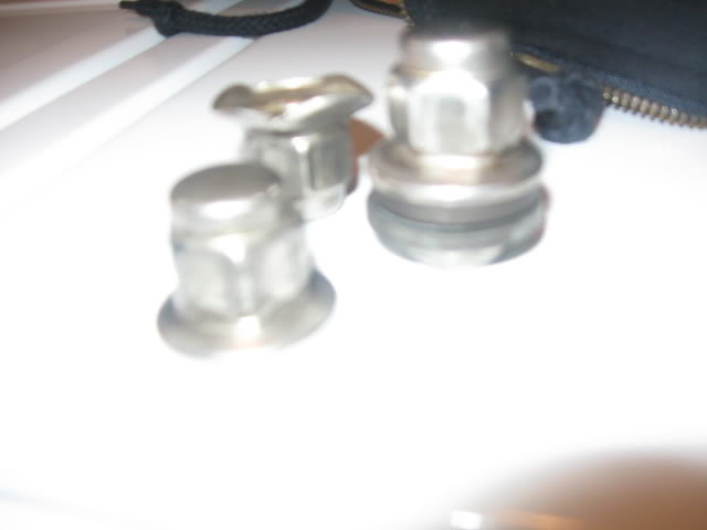

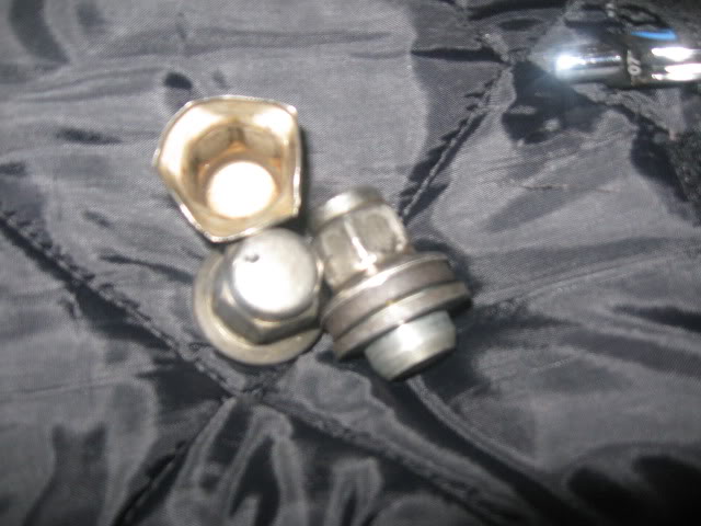

I decided to take a breaker bar and work to break the lugs on the ground one at a time. Started on the same wheel that was giving me hell and popped the cap of the lug off. Once I did that I better understood what I was working with and proceeded to break all the others off. The aluminum cap had seized and needed extra encouragement to come off. In all I had 5 lugs that well needed to be replaced.

Glad you were able to get them off. Brutal (one of the tech's here) had previously given this advice: "use a 3/4” socket, not a metric size, which will likely get stuck and have to be banged out. And don’t use the wrench that comes with the car because you’ll mangle the covers and crack the wrench.....yes it’s that much of a piece of junk."
I never cease to be amazed by stupid little idiosynchracies of the X-Type. Who was the idiot that thought those stupid chromed covers were a good idea?
When I wanted to take my wheels off to rotate them, my bolts were seized too. I took the car to a local tire place and had them deal with breaking them loose. I figured they had the equipment and replacement parts in stock to not leave me stranded (which wouldn't have been the case if I'd done it in my driveway).
After the tires were rotated, I put anti-seize compound on all of the stud threads before hand torquing the bolts back on. Hopefully that will make wheel removal easier in the future.
