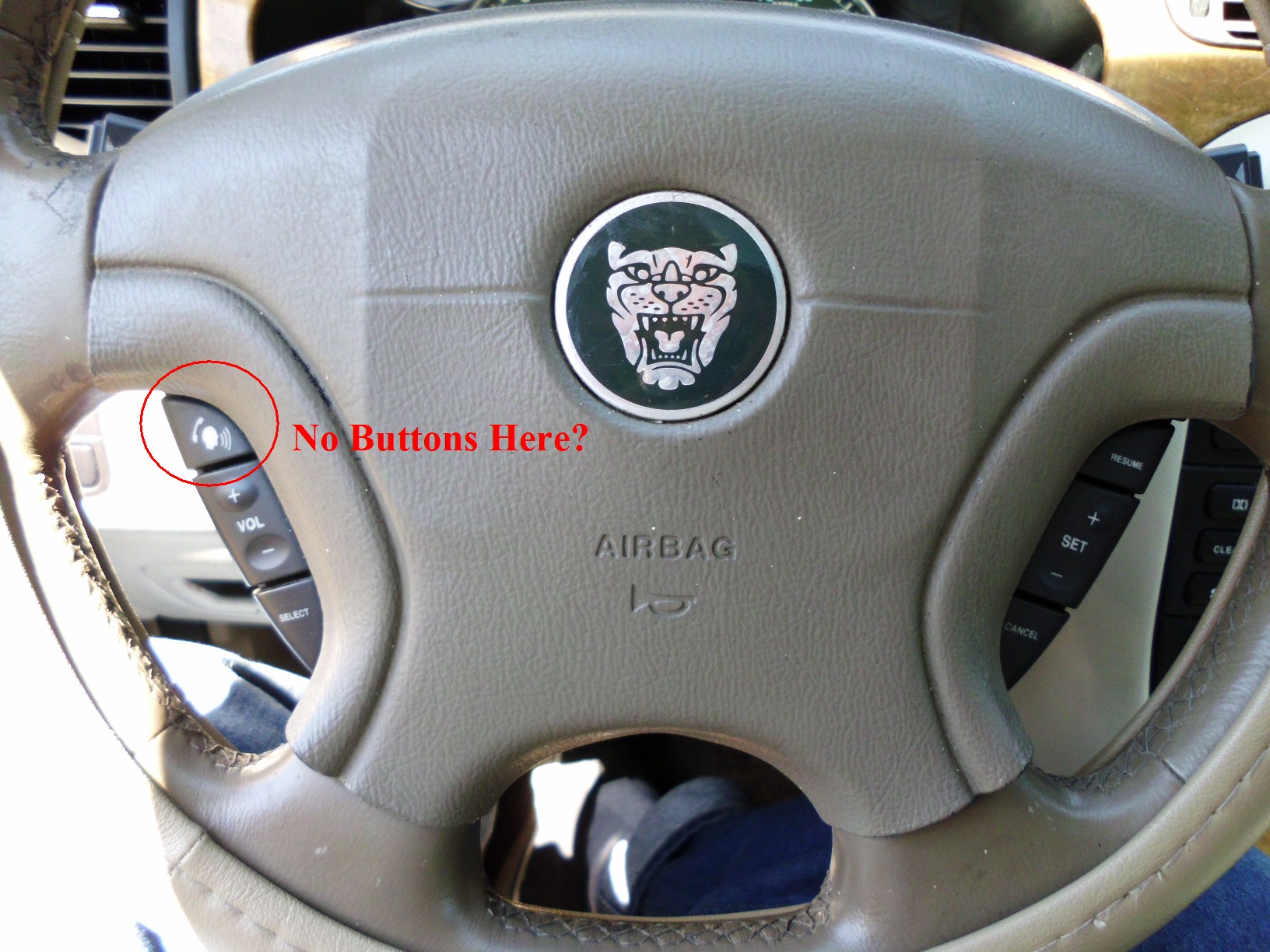

PanamaJag, thanx for the pic but i don't have those buttons on either side.

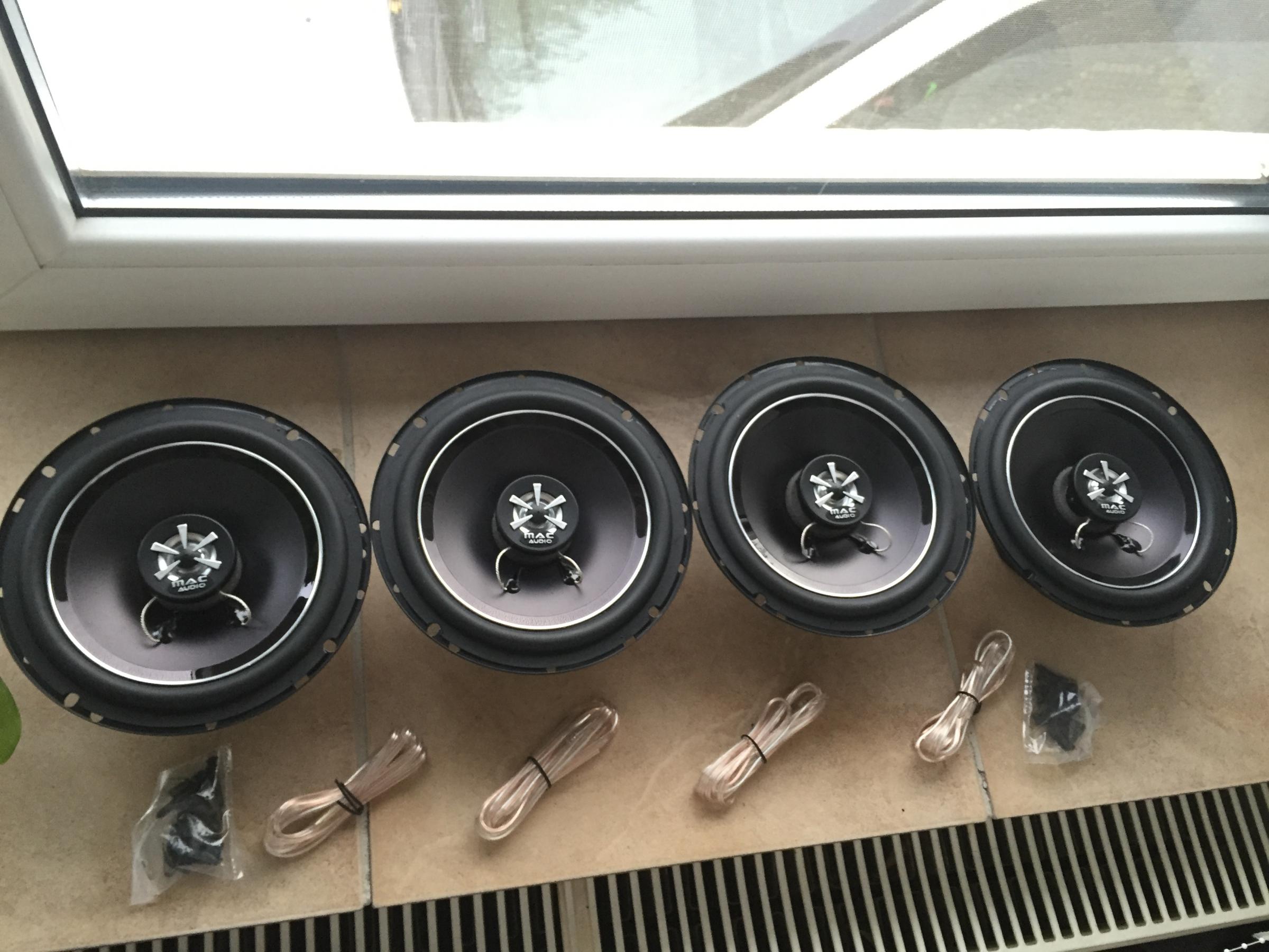

motorcarman: i changed all the speakers too
i read your post on another topic and i tried this.
i bought after market speakers though.

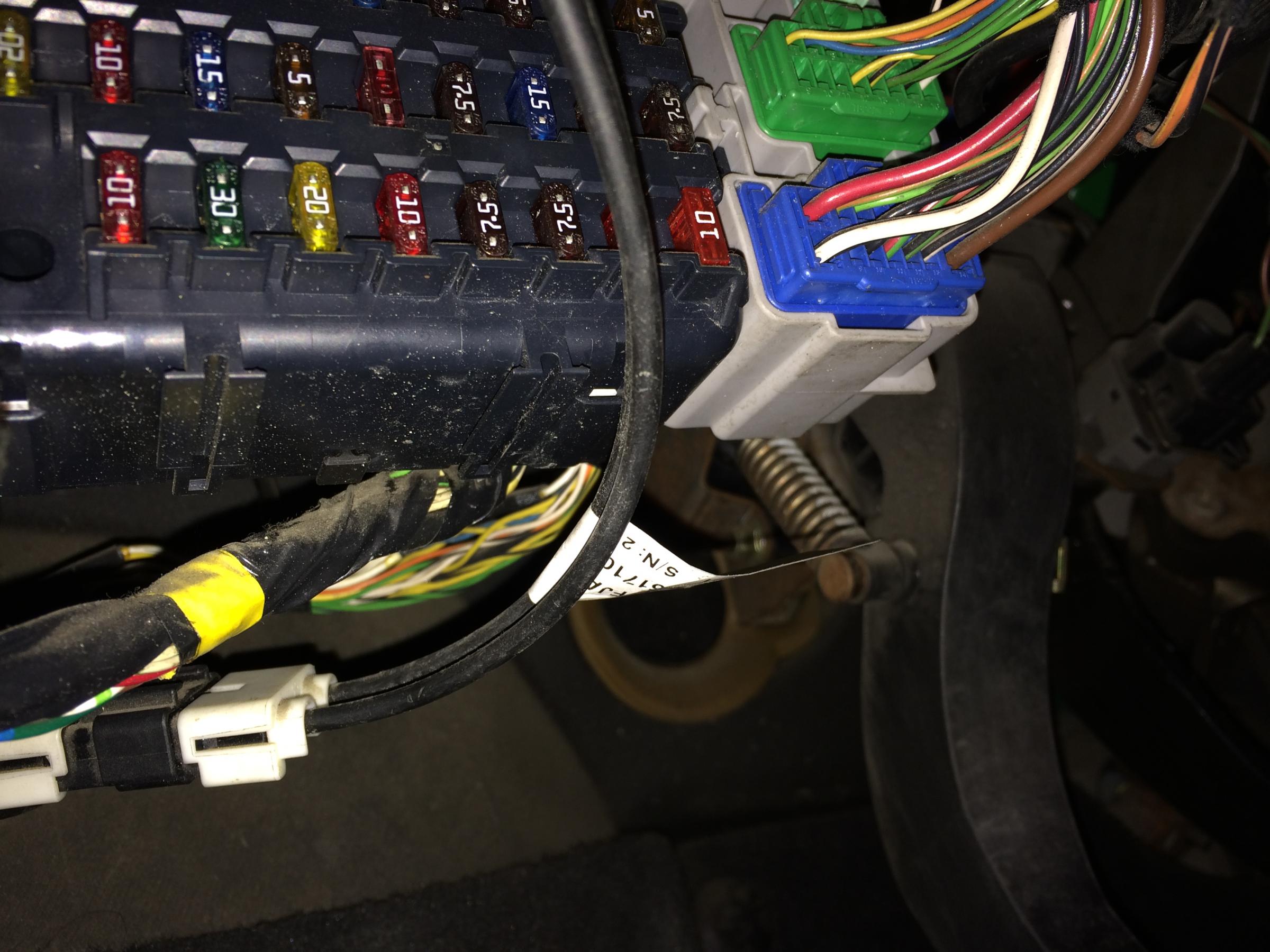

Ok two things I would like you to check.
1. down by where your left foot is when your driving is a fuse box.
Next to the fuse box are some plug connectors your speakers go to the blue plug that has 16 connections see if that plug is still connected.

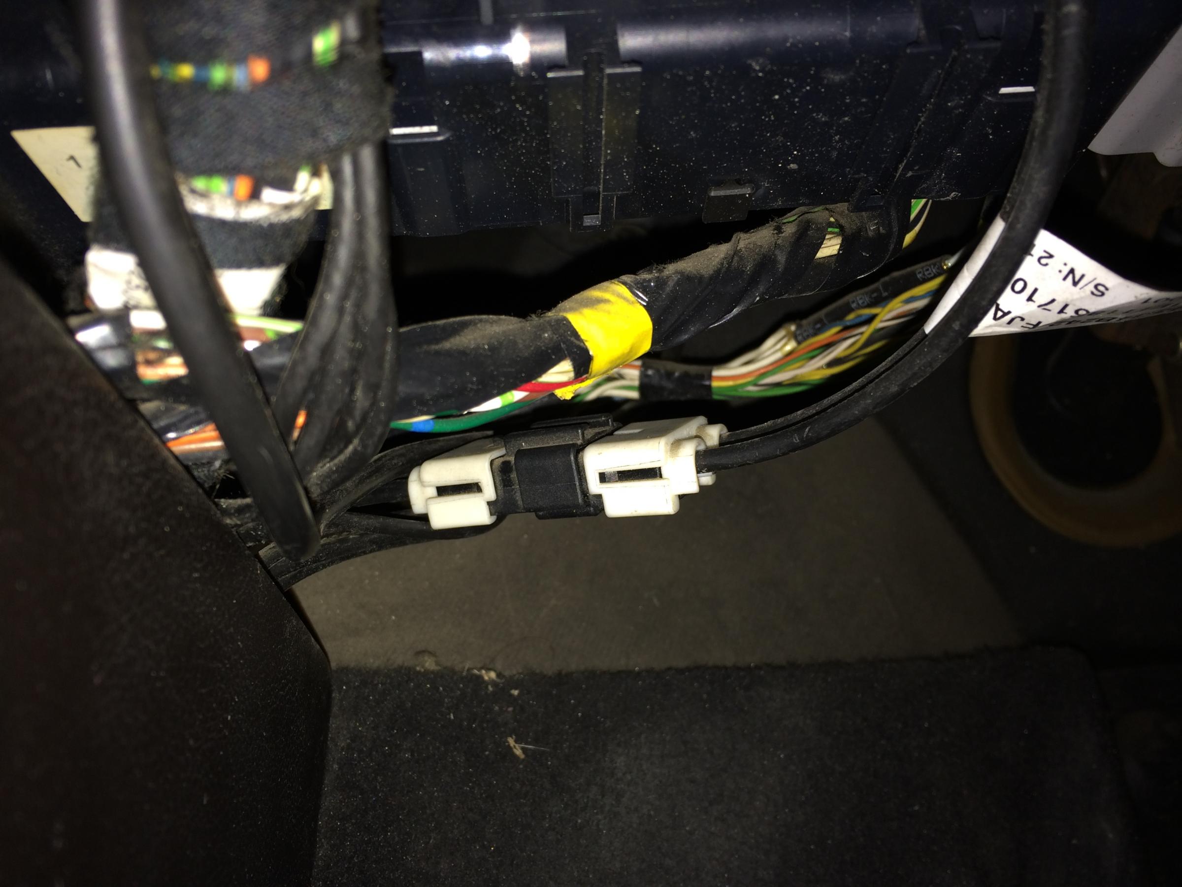

Paulc732: i have checked the cables near the fusebox. everything is plugged in.
check the pictures, maybe you see something that i am missing...

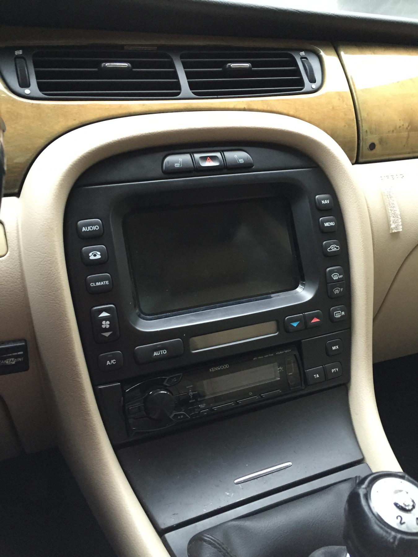

well... problem solved
i had enough of trying to fix it with spare jaguar parts etc.
so i bought an aftermarket kenwood player. no cd. just USB, 3.5mm jack
and it supports FLAC songs.
i hope you guys like how i integrated it
