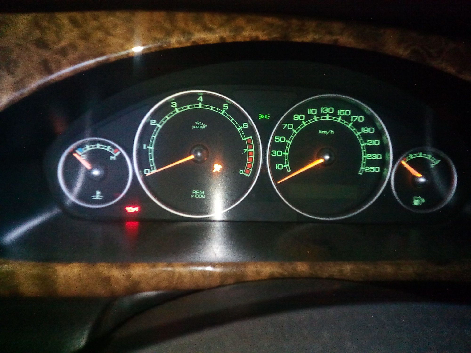

Please assist my car jaguar x type 2.1 2006 model its alarm stays off , traction control not its blank no engine crank, but the car was OK yesterday, it started this morning.
I have checked All fuses-external and internal one by one ( All are fine) .
Battery its fine 12.8 V.
Trunk its doesn't want to open.

Hi Guys
Q-1. Get into the car and leave the door open. This will leave the interior lights on. Now, attempt to start the car.
A-1. Yes the interior light turn on and become dimmer while I am trying to start the car.
Q-2. Do you see a read light near the tip of the e-brake lever? Yes or No.
A-3. No
Q-4.You can also look at the info message center on the instrument cluster. You may see a message about "Security Failure". Do you see this message?
A-4. at the info message center on the instrument cluster its blank:
Please the below image.

Patrick, from the sounds of things, you have 1 of 2 issues. The more likely is that your battery cable(s) are bad and you need to replace them. This is a common problem with the X-Type. Probably a good idea just to replace both. Then lets see what you have then. The other possibility is that your starter gave up the ghost and now is not able to roll the engine. But, that would be unlikely as not many starters have failed on these cars. There are some other really obscure potentials, but we won't start diving down those rabbit holes till we take care of the much more likely issues.
