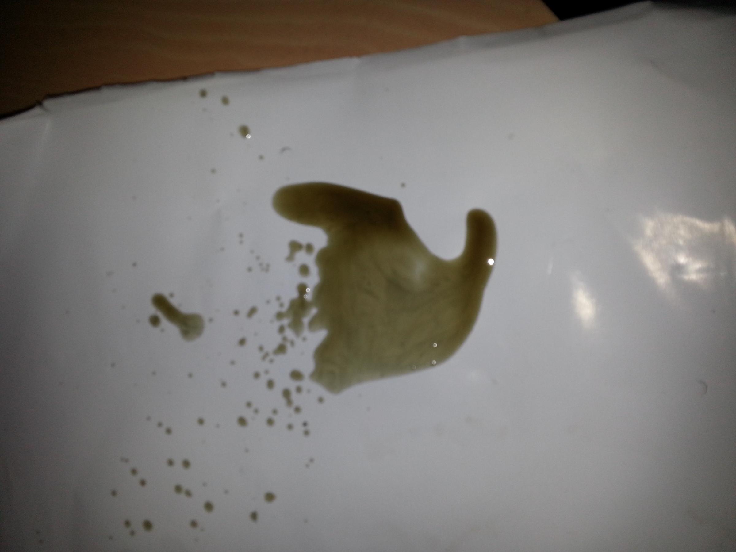

Well took some pics though hard to c clearly, but it is not engine oil or oil filter. Plus I topped up tranny yesterday and it took 2 ltr's of oil and was still not running out of filler hole though must have been close to it as plastic tube on oil bottle when sqeezed then released was sucking oil back up, I understand tranny oil capacity is 1.8ltrs since filling and just checkin on white paper oil has gone from a deffo greyish colour to a mix of new golden brown and dirty grey wich to me points to tranny as this the only oil I have topped up. When looking from underneath oil appears to be dripping from the bottom of bell housing from inside behind dust cover as wen checked yesterday and surplus spray oil from driving and wind under car. when leaking oil startedvdripping out of bottom of bellhousing but there was no sighn of it running down B/Hing eges before drips started. Its deff more of a rapid drip with engine running then slows right down once engine stoped cant see anything from top because of the air box batt box ect can send pics to you but only on a mobile and signal ***** but will go to daughters and use her wifi.
Im thinking it might be the front oil seal on tranny where shaft comes out to enter clutch.
Gears change smoothly no noises rattles or growls from box. Im under the impression that to remove trann engine has to come out!!
Thanks thermo will send pics as soon as I can maybe sending thembto ur email might be easier cheers rob

Hi stu'
heres pics but not real clear all points to font input shaft oil seal.
Would replacing this seal involve stripping box down or does it remove/replace from the outside ie. Bell housing side.
Also do you know how indepth removing Gbox is ie. Removal of engine/sub frame ect
I know my way around cars, 25 years in auto trade but my experience lies on the old school side not all the new technology side, and I dont want to get in over my head, plus I lost my dad on the 1/5/14 and he brought me the car just before he died in november, as you can appreciate this car now holds gr8 sentimental value and I dont want too screw up. But funds are very tight so to do it myself would save alot
Thanks for your help

suprasix, based on the images, it is appearing to me that what you have is a leaking rear main seal. A garage might be able to remove an access cover to confirm this, but it is looking like to me that it is coming from the joint between where the engine and the tranny mate. Add that to the fact of the color of the fluid, it can be but only one thing as I see it.

Well we on same page as to leak, how indepth is job to do ie engine out or insitu best way to remove lump, from top (bonnet) or droping sub frame, will I need specialist tools. Or a lift!! Ect ect. Gr8 big thanks for ur valued advise thermo.

suprasix, I am not familiar with the inner workings of this motor. At a minimum I would think you would need to pull the tranny so you can get access to the seal. Then the question becomes whether it is a split seal that goes inside the block or if it is something on the exterior of the motor that a person can remove and then reinstall (like axle seals). Either way, I think you are looking at having about 6-8 hours of labor to get this taken care of, possibly more. The seal shouldn't be that expensive.

Hi guys, wel garage checked car and they are under the impression that it is the rear engine oil seal, and after checkin out under a ramp pluss collecting oil in a tub im in agreement too, so looks like u are bang on thermo in ur diagnosis too m8 thanks.
I ve put new oil in engine plus a wyns stop leak addertive and have a barrs stop leak concentrate ordered and should be ere l8r todayjust to help me through till.can get it sortedwat with Dads funeral and raising funds too.
