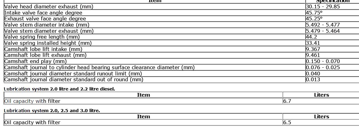

The Jaguar shop manual states 6.5 liters for capacity or about 6.7 quarts. So you should be reading low right now.

My manual says 6.1 quarts, yet the Jaguar shop manual says 6.5 so there you are.
