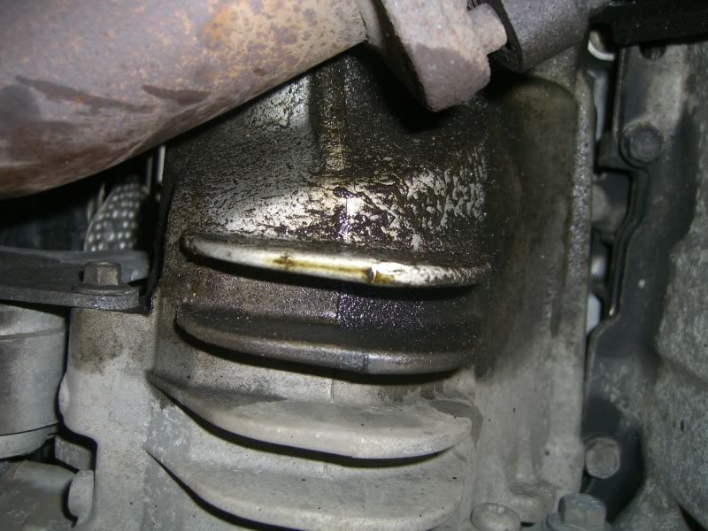

I got my car up on some ramps and noticed that there was some oil collecting on the underside of my car...
It seems to be collecting mostly on what I believe to be the underside of the transfer case (hopefully the pics will help)
The oil is generally quite clean in colour - would this mean that it is unlikely to be the transfer case as the oil would be dirty? I recently changed the oil in my engine, but where would it be coming from?
This is where most of the oil is collecting:

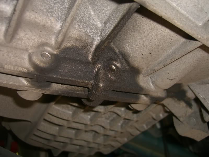

The oil seems to be coming from somewhere up here...

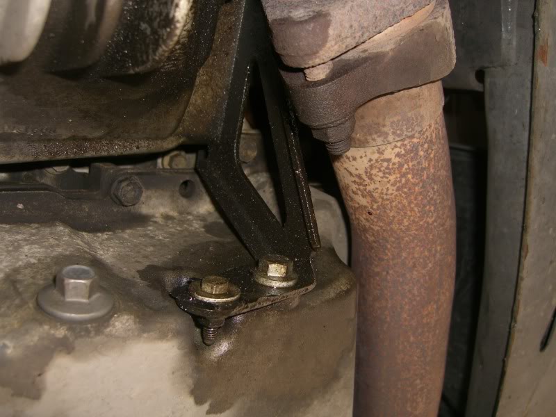

And then oil is also collecting here:

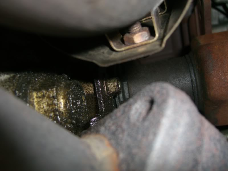

And it doesn't seem like theres any fresh oil here...but any reason why this has residue on?

Gareth, to me, it looks like your right hand transfer case seal is going and is leaking a little bit. It is a common problem with our cars. If you look where the front halfshaft comes in from the right side, you will possibly see where the oil starts at. Beyond that, Not sure what to tell you.
