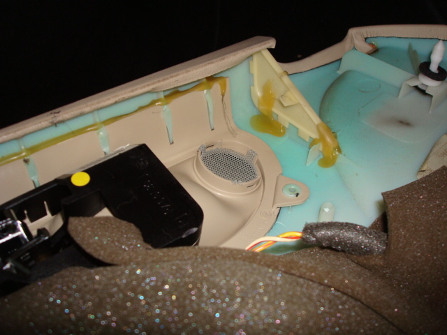

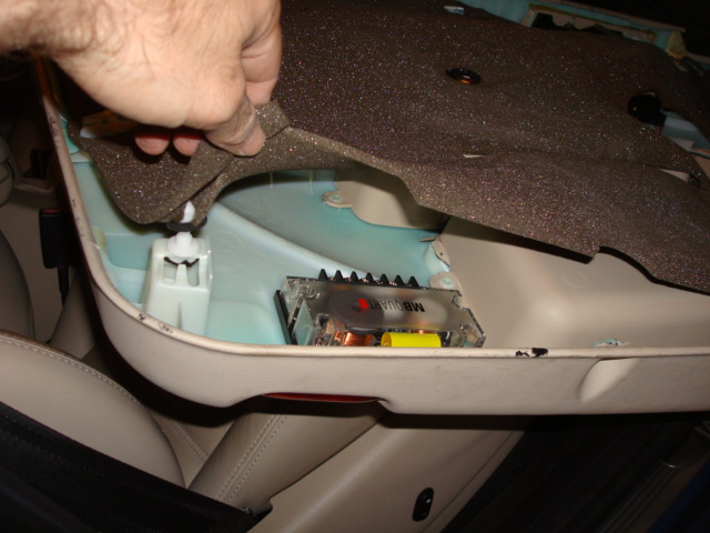

I received my MB Quart component speakers today and decided to give it a try. I followed the steps for taking off the door panel and managed to break 3 clips. I realized I couldn't use the adapter, then thought of a way to use it. Here is a some pics so if anyone wants to save a few bucks and the time to way for an adapter from ebay here you go. I also used the plastic piece that holds the stock tweeter to hold the new tweeter. I was able to angle 3 screws to get my 6.5" mb to go into the stock adapter. I also had to tear out the stock speaker to use it. I used little nails to create small holes for the screws to start in and they help to mark the holes as I put the mb speaker of the stock plastic piece. For the tweeter I took out the stock one and then took of the white plastic piece and glued the mb tweeter to it, then re-attached it.
