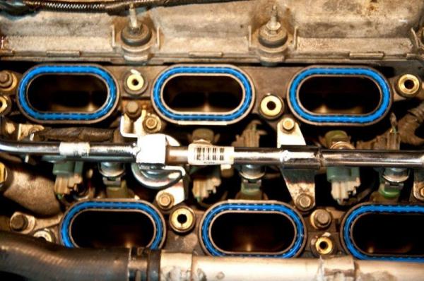

Taking out the MAF is easy. However, you cannot tell if it is dirty by manually inspecting it. You should pick up some CRC MAF cleaner and spray the sensor clean. Be careful not to touch it, since the sensor is very delicate and may break.
I would also, clean the throttle body as well.
I've attached pictures of the MAF sensor and the 6 upper gaskets and 6 lower gaskets - below the fuel rail. Just to make sure we are on the same page for the 12 gaskets.

My notes say that I replaced the 6 gaskets "on the intakemanifold" in May 2011. Those should be the 6 in your picture. I'm wondering where the other 6 are that youmentioned.

The other 6 gaskets are under the lower manifold. See this thread for pictures:
https://www.jaguarforums.com/forum/x...ted-how-62847/
