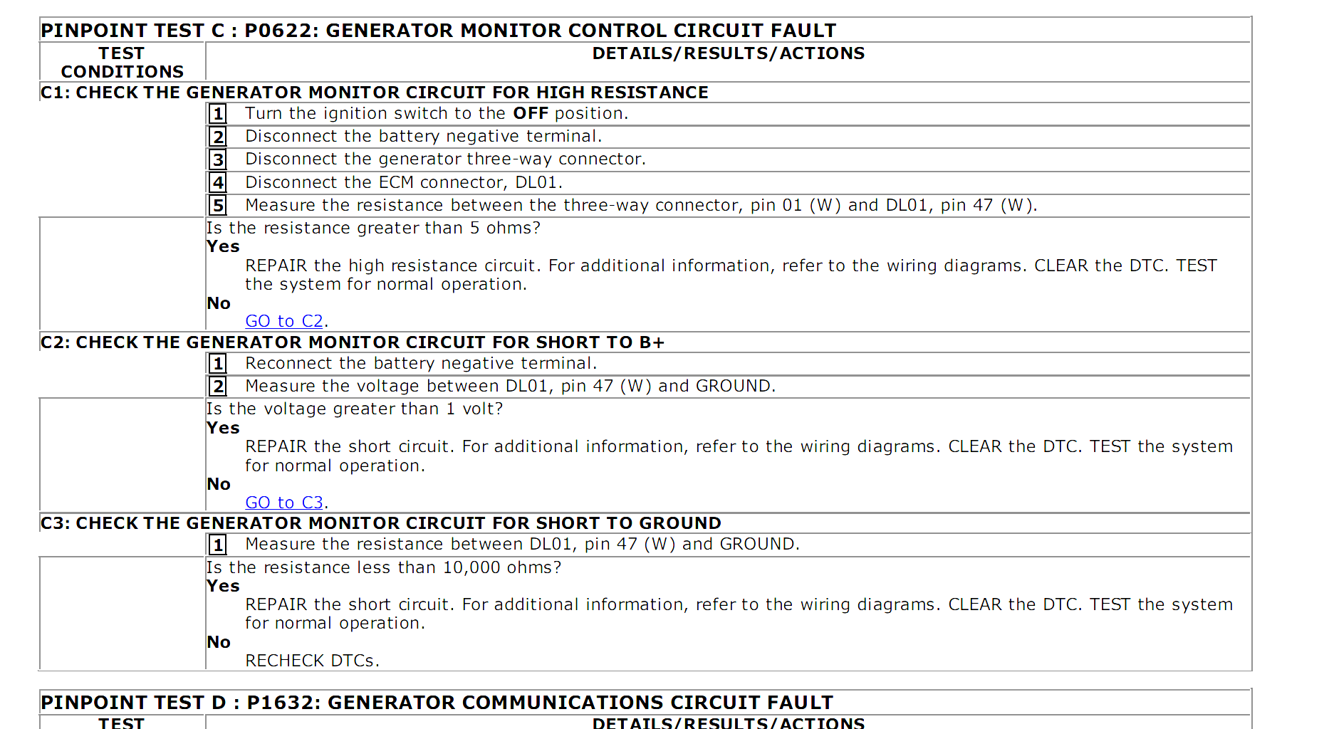

Yea, I was going to check those tomorrow, I have the workshop manual and stuff and I was looking over those troubleshooting steps earlier.

But I did some further testing, the 3 tests in the workshop manual for P0622 (voltage, 2 resistance tests) and they all came back fine.

But yea, I'm pretty sure the alternator is regulated by the ECU alright, because the troubleshooting steps in the manual for P0622 only focus on the wire going to the ECU (DL01), and the ground wires. And the "possible sources" also include an ECM fault.

I did these tests listed below alright, the ones listed in the workshop manual.
