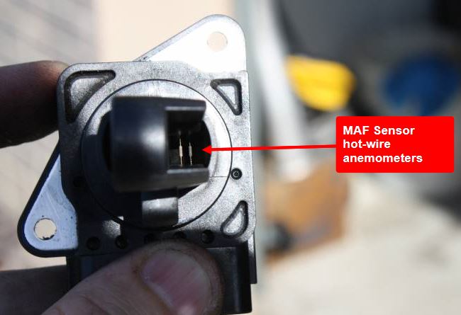

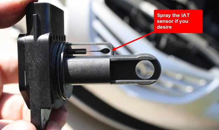

Patterson: Leaks in your X-Type's airbox won't cause MAF and IAT errors. But fix the leaks anyway to keep road grit out of the engine intake.
Our X-Types, like many cars, have an IAT sensor inside the MAF sensor. So your MAF & IAT errors are probably: (1) a bad MAF sensor, (2) a loose or damaged electrical connector to the MAF sensor, or (3) as JagV8 says, damage to the MAF sensor wires.
These pic's show the IAT sensor inside the MAF sensor.
