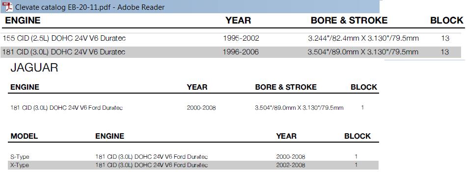

Engine blocks are identical 2.5 and 3.0 from 95 то 08

car5car, the stroke/bore may be the same over the years, but the blocks have slight variances between the different models that they were put into. For example, in the Ford Fusion, the water pump is on the front of the engine. Yet, in our Jags, the water pump is on the back side of the engine. The Fusion does not have the IMT valves where the Lincoln and the Jag do. So, you are correct on some parts of the car, but it is not a 100% garantee though either.
