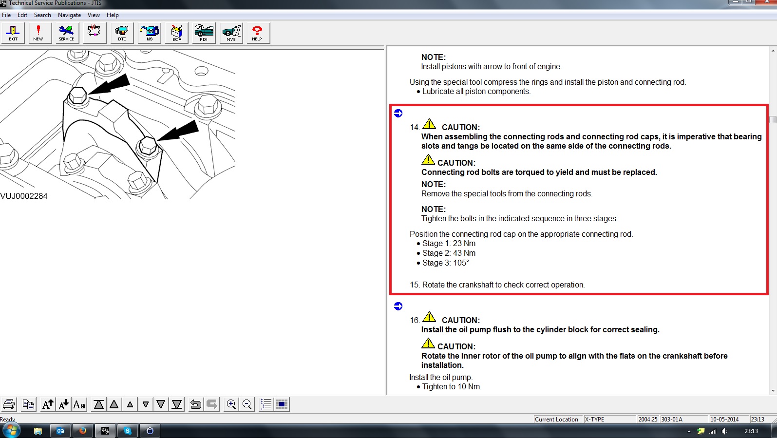

Please let me know specs torque for connecting rod bolts 2.5

Here is the relevant section from JTIS:

Here's what the workshop manual has to say:
Attached Thumbnails Please let me know specs torque for connecting rod bolts 2.5-conn_rod.png

Thanks, guys!!!!
Great help. I have that service manual, I couldn't find that. I guess, I am not smart enough...
I click service manual: powertrain- engine-in vehicle repair
It should be in Assembly/ disassembly section, but I don't have it. I downloaded manual from here.
