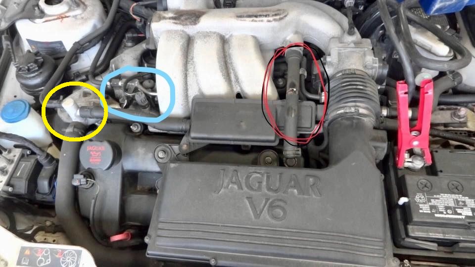

2002 2.5 awd/auto..hopefully located coolant leak....left hand side of engine....a pool of coolent sitting below where the two metal pipes join..{just beside intake manifold}...not sure if coming the pipe joint?....where else could be the leak be from?...... Could it be the Intake Manifold Gasket or the dreaded Head Gasket ? ...Any thoughts most welcomed!

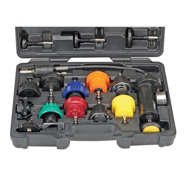

The best way to find a coolant leak is with pressure tester. Some auto parts stores will either loan or rent one. Its the safest way since the engine isn't running and the coolant isn't hot.
The best place to post issues with your car is under model specific section.

Needing help! 2002 2.5AWD auto./petrol located coolant leak / left side of engine...a pool of coolantsitting in valley below to the right of the where two metal pipes join {thisbeyond the oil filler) have used someone’s photo / blue circled location......
Could it be the dreaded Head Gasket ? {click on picture to enlarge}

You will most likely need to remove the upper and lower intake manifolds to gain access to locate source of leak.
There is a black pipe that connects to water pump and runs under the lower intake manifold towards the front of the engine. I have seen this pipe corrode through and leak. There should also be a rubber hose under as well, this could also be leaking.
Another possibility - in your picture, where the blue circle is. Just to the left of that is a junction, I've circled it in yellow. This is held in by 1 bolt, and there is an o-ring that has been known to leak. Odds are its the pipe or hose below the intake manifold.
