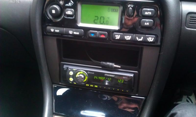

Default How to replace stereo with non stanard
You'll need the following bits available off ebay.
JAGUAR X-Type Car Steering Wheel Stalk Adaptor PC99-X47
JAGUAR X-Type Car Steering Wheel Stalk Adaptor PC99-X47 | eBay
JAGUAR S-Type, X-Type 2001> Car CD Stereo Fitting Kit Fascia, Wiring ISO Aerial
JAGUAR S-Type, X-Type 2001> Car CD Stereo Fitting Kit Fascia, Wiring ISO Aerial | eBay
Also attached is a manual of how to fit the above bits.
That's what I've done. My stereo (Panasonic DEH-P55BT) is blue tooth and plays mp3 CD's Which fit about 10 albums on so no need for a cd changer if you can be bothered to rip your CD's to Mp3 then make a data cd of the albums.
I've also attached a 3.5mm audio jack cable so I can watch telly on my phone and use the in car audio system. That hides neatly away when not in use.
I admit it's not as neat as the factory standard, but far more practical. The only problem with my stereo is that the clock only displays when it's on standby, which is kind of annoying. So make sure you get a stereo with a clock which you can display during playback of your music is my advice on that front.
Alternatively you can get a jaguar audio connectivity module.
I've attached a pdf of how to fit that, but it looks a bit too fiddly for my skills.
You can get them fitted by your Jaguar dealer.
Jaguar UK - The Jaguar Audio Connectivity Module is now available
Hope this helps.
Jonesy
Attached Thumbnails Question about changing 06 x type radio, amp & sub-stereo.jpg   Question about changing 06 x type radio, amp & sub-stereo-cable.jpg

Thanks a bunch. That's going to help so much. Just one more question. I noticed in the pdf that a smaller radio needs the radio housing. Would that be the case for bigger touch screen radio?
Old Mar 18, 2012 | 11:21 AM
jonesy1974xtype's Avatar
Posts: 137
Likes: 33
From: mcr
Not sure, You'll have to check the dimensions with the supplier, but you may be able to carefully remove the cross piece to create one large hole rather than two small slots, or ask if he does a different one for full screen stereos.
Cheers,
Jonesy
