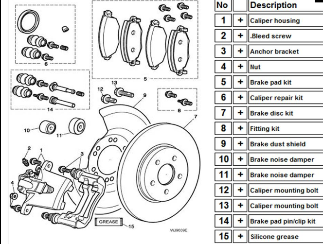

Also could somebody offer a diagram of the front brakes and all the parts that should be there?
Old Sep 17, 2014 | 10:00 PM
dwclapp's Avatar
Posts: 809
Likes: 289
From: Houston, TX
Here ya go....

First things first; check the bolts that secure the brackets on. They must be properly torqued; too loose, and they'll back out, too tight and they'll stretch and either back out or just loosen up enough to cause clunks.
The are a real PITA, too; I needed an open-box-end 'socket' for my torque wrench.
They don't take a LOT of torque, they really aren't squeezed on there all that tight, but the actual amount is muy importante!

do you mean the caliper retaining bolts on the diagram above?

They are two 15mm that hold on the anchor plate.

hey spike. There is a round weight in the back of the brakes. Its a noise dampener or something. I had a noise and removed those and the noise was gone. Just a thought.

Spike / Dr: The round weight the good Dr. describes is part #10 / 11 in this brake diagram, and circled yellow in this picture.
It's a noise dampener / vibration suppressor. When the retaining nut loosens, the round weight makes a "thunk" noise with every bump in the road. Ask me how I know.....
Determining that the thunk noise was being caused by the loose round weight wasn't easy, because noise travels through the suspension, and these round weights are "concealed" on the inside, top of each rear caliper.
Spike describes his thunk noise as occurring with bumps, and when he brakes and reverses. The thunk from my loose weight occurred on every bump, but not when braking or reversing. So it's unclear if Spike's Jag also has a loose brake weight, but it's easy to check and rule out.
