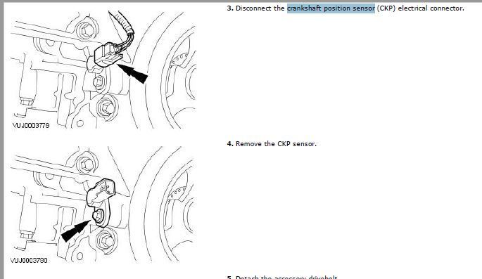

Last step for now, check the wiring for the crankshaft position sensor and make sure it has come loose from the sensor or is damaged, clean the contacts for the sensor and remove and clean the face of the sensor.
The sensor can be accessed by removing the passenger side tire and the wheel arch inner cover. The sensor is located behind the crankshaft harmonic balancer on the front of the engine.
