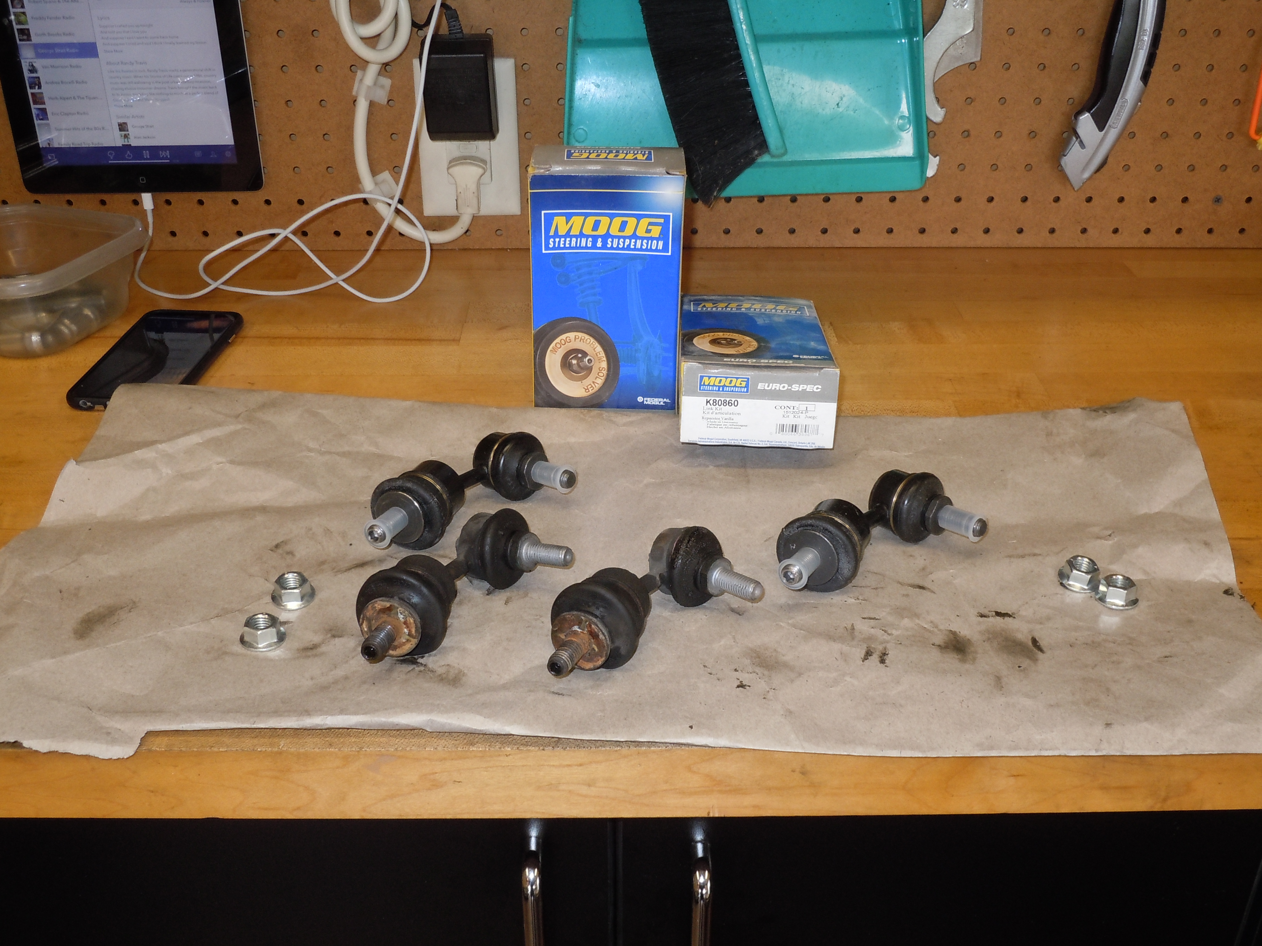

Is the one that just broke a Moog part? Where did it break? I replaced both links on my 2004 with 105k miles two months ago. The parts I removed were in good shape.
