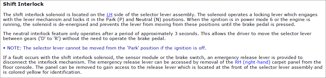

I've never had to try it but, this is what the workshop manual has to say.
Attached Thumbnails Putting an automatic in neutral (manually)-interlock.png

as clyons mentioned, top left hand side of the gear selector there is what seems to be a little cover that you can take off with your nail (or flat head).
should be easy to do
