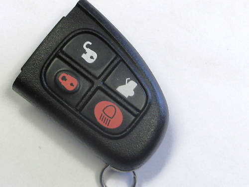

It's real easy to tell the difference. Let me illustrate.
To start, I'm guessing you have two of the first picture.
The second and third pictures are of the remote/key fob with the key locked in and out.
The fourth picture shows the remote half. This one is easy to get on ebay.
What you dont' see in the fourth picture is the key half which is the upper part of the fob. This one, you would want brand new and not just with the blade replaced since the plastic holding it in eventually wears.
The tricky part is to get the keys cut when you buy it. So, you may want to check the parts guys locally first and see how much that would cost. Then, call Dan or Steve at Nalley Jaguar and see if they'd be able to help you with this.
Since you have two working keys, you should be able to program the keys and remotes yourself.
Good luck!

Exrub, I can't view the images you posted. Guess I don't have permissions yet??
So are you saying that I should buy the remote half of the key, and then insert my "regular keys" or...?
Let's try it this way.
I'm sure you have access to ebaymotors, right?
Here goes:
Is this the key you have? Item #160504097159. If so, they can still be used as spares/backups once you get your remotes together.
Here's what the key/remote fob looks like with the key extented. Item #170562256012.
Notice that this ad says "cut key". This will not help you so avoid.
Here's what the remote half looks like. Item #260688411310 and #120643645336. In fact, I bought mine from these two vendors. One has the "Buy It Now" option while the other requires you to be patient. Either one would be a lot cheaper than from a dealer, though, even if you get two from the one with "Buy It Now" option.
Notice the difference between the remote half and the fob together. The upper portion with the button to release the key is the key half. This is the piece that I recommend you get from a dealer parts dept since what you normally see on ebay will say "new blade". This means new blade ONLY.
Now, when you fold the key in, it looks like this. Item #230521580096.
Hope this helps!
