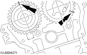

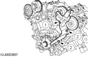

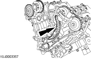

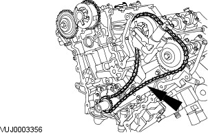

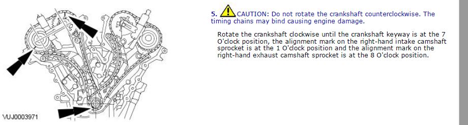

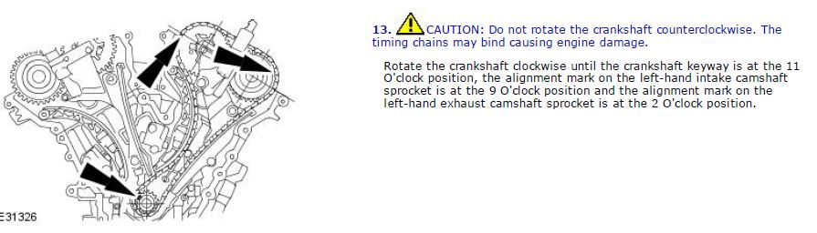

I tend to agree with Thermo,, timing is most likely your problem. Below is a diagram of the timing marks and the correct locations for them when installing the chains. Even though the chains have marked links there orientation is not important to correct timing. The location and orientation of the timing marks is the important factor.
Attached Thumbnails Replaced Timing Chains and Won't Start.-left-side.jpg   Replaced Timing Chains and Won't Start.-right-side.jpg

Goodevening Avern1,
thanks for your fast response.
the pictures, do they come from a manual? please send me the link. or are the pictures from the 2810 pages workshop manual?
i clearly see where the timing marks should be.
Please correct me if i am wrong.
let's say i use picture 1 (with step 13 written on it) my timing marks should be in that positions.
crankshaft keyway at 11 oclock
LH intake camshaft at 9 oclock
LH exhaust camshaft at 2 oclock
so that's done, they are in the correct positions.
THEN, should i proceed by TURNING the crankshaft keyway to the position as mentioned in the second picture (with step 5 written on it) - from 11 oclock to 7 oclock?
BECAUSE, in that case, in the second picture (with step 5 written on it)
i will start with the;
crankshaft keyway at: 7 oclock
RH intake camshaft at 1 oclock
RH exhaust camshaft at 8 oclock.
is this how i should install the chains? in this order of movements?
Please correct me if i am wrong, i am here to learn.
again, please send me the link of the chain instalation guide you used. if you did.
greetings bastiaan

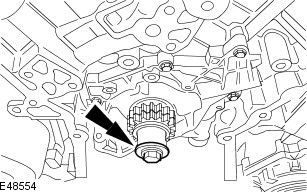

Silly question....... but did you make sure this guy in the picture below is installed, and installed facing the correct way?

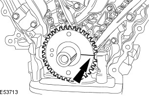

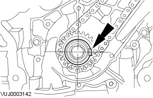

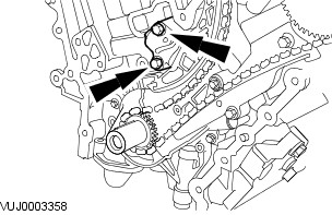

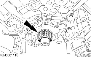

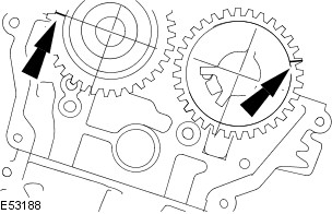

NOTE:
Note the position of the crankshaft position (CKP) sensor pulse wheel during removal. It must be returned to its original position during installation.
Remove the crankshaft position (CKP) sensor pulse wheel.
CAUTION:
Do not rotate the crankshaft counterclockwise. The timing chains may bind causing engine damage.
Install the crankshaft pulley retaining bolt and washer.
CAUTION:
Rotate the crankshaft clockwise until the crankshaft keyway is at the 7 O'clock position, the alignment mark on the right-hand intake camshaft sprocket is at the 1 O'clock position and the alignment mark on the right-hand exhaust camshaft sprocket is at the 8 O'clock position.
Release the timing chain tensioner ratchet.
NOTE:
Keep the timing chain tensioner ratchet released.
Reposition the timing chain tensioner plunger.
Retain the timing chain tensioner plunger.
Remove the right-hand timing chain tensioner.
Remove the right-hand timing chain outer guide.
Remove the right-hand timing chain.
CAUTION:
Inspect and replace the O-ring seal if necessary.
Remove the right-hand timing chain inner guide.
CAUTION:
Rotate the crankshaft clockwise until the crankshaft keyway is at the 11 O'clock position, the alignment mark on the left-hand intake camshaft sprocket is at the 9 O'clock position and the alignment mark on the left-hand exhaust camshaft sprocket is at the 2 O'clock position.
NOTE:
Right-hand bank shown, left-hand bank similar.
NOTES:
  • Right-hand bank shown, left-hand bank similar.
  • Keep the timing chain tensioner ratchet released.
NOTE:
Remove the left-hand timing chain tensioner.
Remove the left-hand timing chain inner guide.
Remove the left-hand timing chain.
CAUTION:
Remove the left-hand timing chain outer guide.
CAUTION:
Make sure the crankshaft keyway is at the 9 O'clock position before any further engine repairs are carried out.
Remove the crankshaft pulley retaining bolt and washer.
Remove the crankshaft sprocket.
Installation
  1. NOTE:
    Make sure the crankshaft sprocket timing marks are facing outwards.
    Install the crankshaft sprocket.
  2. CAUTION:
    Make sure the crankshaft keyway is at the 9 O'clock position before the camshaft positions are aligned.
  3. Rotate the left-hand intake camshaft clockwise until the camshaft sprocket alignment mark is at the 9 O'clock position and rotate the left-hand exhaust camshaft sprocket clockwise until the camshaft sprocket alignment mark is at the 2 O'clock position.
  4. Rotate the right-hand intake camshaft clockwise until the camshaft sprocket alignment mark is at the 5 O'clock position and rotate the right-hand exhaust camshaft sprocket clockwise until the camshaft sprocket alignment mark is at the 12 O'clock position.
  5. Rotate the crankshaft clockwise until the keyway is at the 11 O'clock position.
  6. CAUTIONS:
    • Inspect and replace the O-ring seal if necessary.
    • Make sure the O-ring seal is correctly installed.
    Install the left-hand timing chain outer guide.
    1. CAUTIONS:
      • Make sure the crankshaft keyway is at the 11 O'clock position, the alignment mark on the left-hand intake camshaft sprocket is at the 9 O'clock position and the alignment mark on the left-hand exhaust camshaft sprocket is at the 2 O'clock position.
      • Make sure the timing chain alignment marks are correctly positioned to the crankshaft sprocket and camshaft sprocket alignment marks.
      • Make sure the timing chain slack is on the tensioned side of the timing chain.
      Install the left-hand timing chain.
    2. Install the left-hand timing chain inner guide.
    3. CAUTION:
      Do not manually adjust the timing chain tensioner.
      Install the left-hand timing chain tensioner.
      1. CAUTION:
        Make sure the left-hand timing chain alignment marks have remained correctly positioned to the camshaft sprocket and crankshaft sprocket alignment marks.
      2. CAUTION:
        Remove the timing chain tensioner retaining pin.
      3. CAUTION:
        Rotate the crankshaft clockwise until the crankshaft keyway is at the 3 O'clock position.
      4. CAUTIONS:
        Install the right-hand timing chain inner guide.
        1. CAUTIONS:
          • Make sure the crankshaft keyway is at the 3 O'clock position, the alignment mark on the right-hand intake camshaft sprocket is at the 5 O'clock position and the alignment mark on the right-hand exhaust camshaft sprocket is at the 12 O'clock position.
          Install the right-hand timing chain.
        2. Install the right-hand timing chain outer guide.
        3. CAUTION:

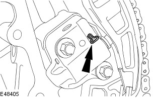

          Install the right-hand timing chain tensioner.
          1. CAUTION:
          2. CAUTIONS:
            • Make sure the right-hand timing chain alignment marks have remained correctly positioned to the camshaft sprocket and crankshaft sprocket alignment marks.
            • Do not manually adjust the timing chain tensioner.
            Make sure all the timing chain alignment marks are in the positions shown.
          3. CAUTION:
            NOTE:
            Rotate the crankshaft using hand tools only
            Rotate the crankshaft two complete turns clockwise to make sure the valves and pistons do not clash.
          4. CAUTION:
          5. CAUTIONS:
            • Make sure the CKP sensor pulse wheel is correctly installed with the missing tooth aligned to the crankshaft keyway.
            • Make sure the CKP sensor pulse wheel is correctly installed with the teeth pointing outwards.
            Install the CKP sensor pulse wheel.
          6. Install the spark plugs.
            1. Install the engine front cover.
              For additional information, refer to: Engine Front Cover (303-01 Engine, In-vehicle Repair).
