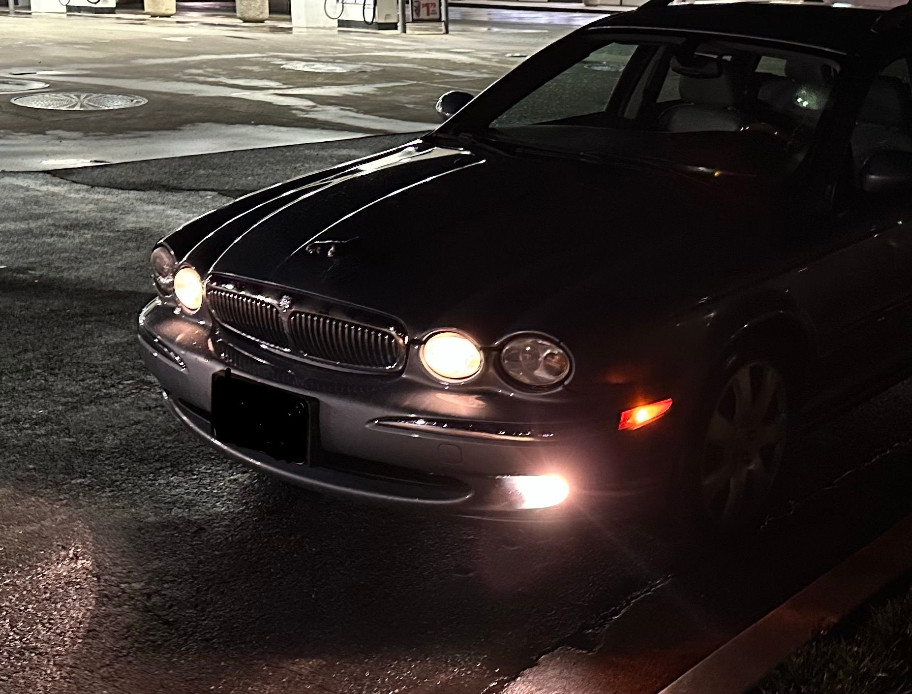

I was super confused too at first when I got my 2005 Sportwagon. For a halogen US car (and highly doubt this different with HIDs) the front parking lights are white instead of amber. They are those dim white bulbs inside the high beam. I thought front parking lights in the US had to be amber but I looked it up and that is traditional but not actually required by law. The orange bulbs inside the headlights are turn signal/hazards only. Jaguar has something of a habit of only using 1 filament of a 2 filament bulb...
This is with the parking lights and the front fog lights on. (US 2005)
