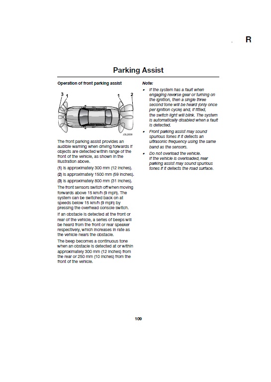

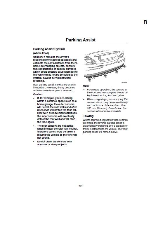

Old Feb 25, 2013 | 07:33 AM
Here's the relevant pages on Parking Assist from the Driver's Handbook for your MY.
I know these books often go missing.
