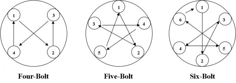

You might have a caliper that is dragging on that wheel, and that can heat up a rotor pronto.
Just feeling the wheel with your hand after a few miles can answer the question. If it's hot, you will know it - it'll be hotter than hell.
Yes, a torque wrench is vital. I even carry mine in the trunk, just in case I ever have to change out a flat tire. When I use it, I tighten the nuts up in two or three steps, 1/2 torque to begin with, and full torque final.
Also, you must alternate the bolts you are tightening, using a "star" pattern. Just going in a circle - one bolt to the next bolt to the next, etc - will warp your wheels and/or rotors before you even drive the car. Every time.
Best 'o luck.
Attached Thumbnails Steering wheel shuttering while braking-lugbolttorquepattern.jpg

Wink torquing
It is also important to recheck after 50-75 miles in the same pattern, especially on aluminum and magnesium wheels because they expand and contract more than steel or carbon composite wheels. That is why the disclaimer when you have them mounted or rotated at the shops.

Ok I'll have to get a torque wrench. But I'll check it again, my friend had a lift so ill check out the rotors.
