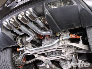

If you do decide to install a Supercharger (Blower), do a search for one that is compatible with a V6 intake.
(This kit is for a Mustang)
Or, check on the possibility of installing a belt driven turbo. (Not much room in the engine bay for either to be installed).
Might check on installing a turbo under the body?
One last note: Jaguar is introducing a 3.0 supercharged engine in the 2013 models. (Engine Swap?)
Attached Thumbnails supercharger in x type-blower.jpg   supercharger in x type-belt-turbo.jpg   supercharger in x type-turbo-3.jpg
