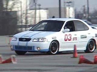

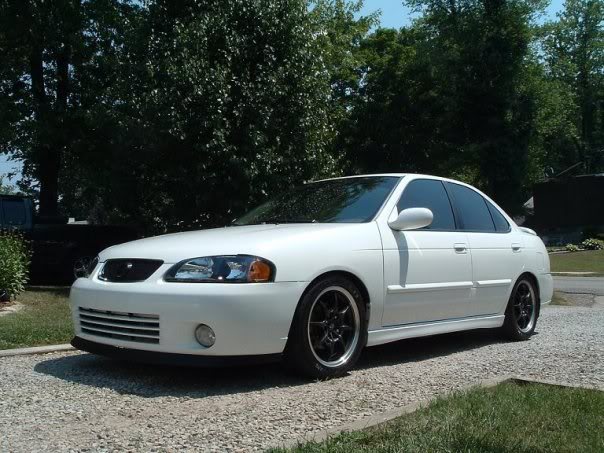

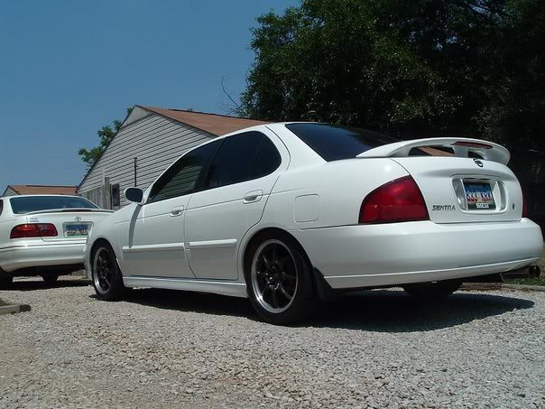

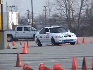

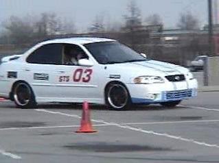

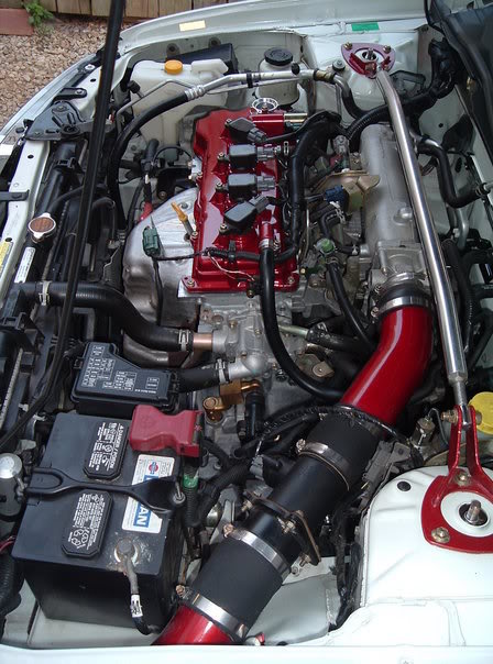

Ah, I remember my autox days. Here's my pre-X-type baby...althought the one that came before this will always be the *first* baby..

Hey 310.........love the car mate
What a really nice clean lookin example.....the engine bay looks great

Sweetride 310...how come all those cones are laying down...[sm=smiley32.gif]
