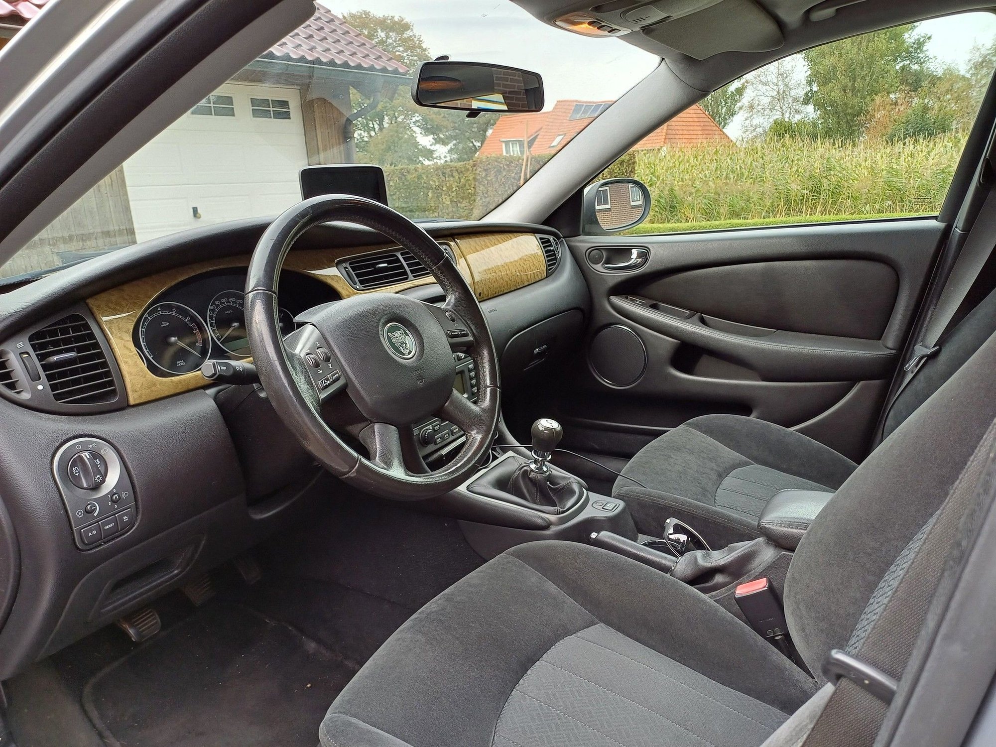

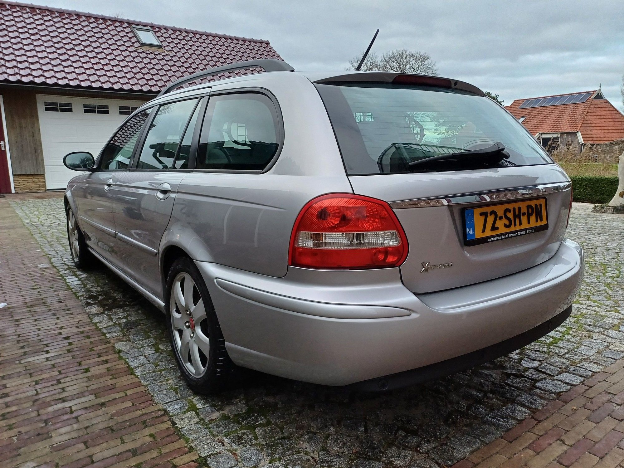

I have a X-type Estate 2.1 manual as a daily for over a year now.
I am pleased with it, it behaves as a modern car, with some more comfort compared to my XJ40's.
Being a base model it does not have leather, although the cloth seats are very comfortable.

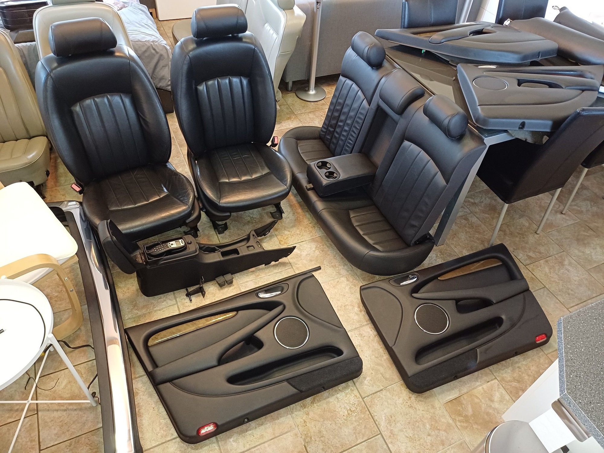

A while ago i could buy a leather interior from a saloon model almost for free.
Since it was in neat condition i bought it.
But what can i use from this sedan interior into my estate?

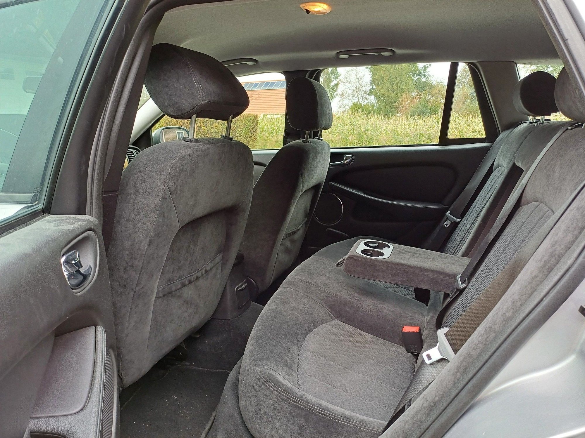

I know the backrest of the rear bench won't work, but what other parts will give me problems?
Thanks

The back won't fit because the seatbelts and locking mechanism of the back of the seat is different.
I was hoping someone did this before, before i tear it apart only to find out it won't fit :-).
What about the actual size/dimension of the rear backrest: Sedan vs. estate?
If the backrest is about the same size, the solution of your problem is kind of obvious:
Don't swap the entire rear backrest, but only swap the leather cover over onto your own rear backrest.
