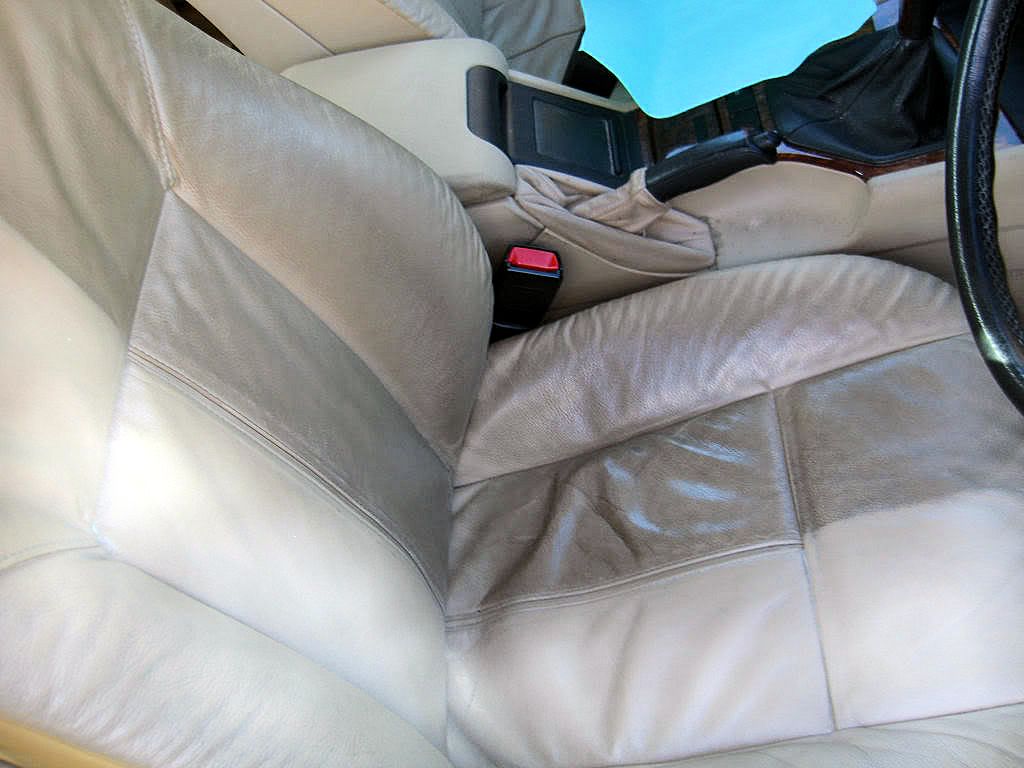

I see the word "dyed" mentioned a lot above. Actually the seats, in the X100 and most leather cars seats I know, are actually 'painted'. So its mainly a surface treatment rather than a change of leather colour. So it should be a case of carefully sanding off the last paint and then painting on a new, flexible, colour. So going from black to white or white to black is not much of a challenge. The biggest challenge is prep. Removing as much surface paint as possible then treating the leather ready for its new colour.
I have treated many seats over time but basically going from 'What a mess' to 'thats nice'. If your confident enough to remove your trim and seats from the car it should not be too hard a task for you. So called professionals often do not make as good a job of the work as you would. If you seperate the job into 4 tasks and take your time with each you can end up with some nicely done seats. Though I have to confess I do prefer the original colours of your seats, or color as you are in the states?
Will try and dig up some pictures of the seats I have tackled.
Update.
Found the pictures I talked about above. Rather than copy and repost its easier for me, being lazy, to post this link for you to see. Click here to see SOME of the leather I have repaired.
To temp you a 'half and half seat'. This is the interior of a car I bought cheaply, you can see why. I put a plastic sheet over one half of the seat and did the other side so I could see a good before/after work on the seat. Bit of a difference isn't there?
