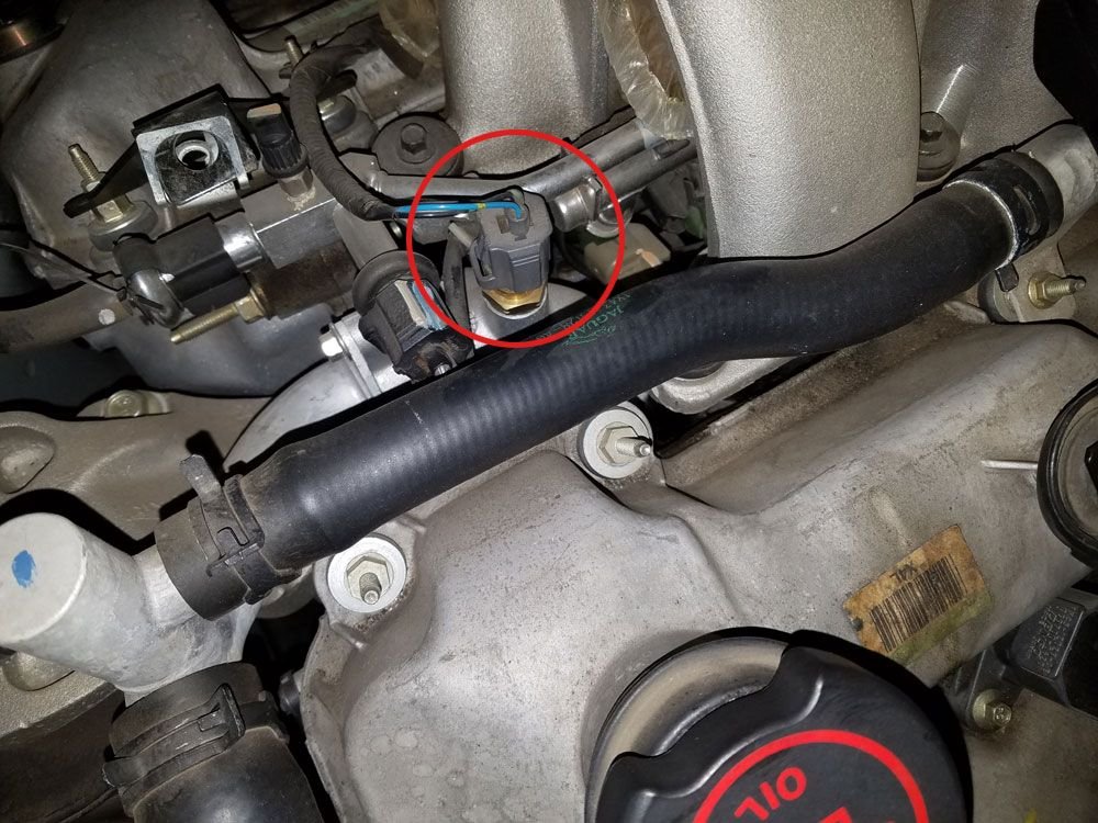

Where is the plug and the sensor located if you don't mind me asking? Thank you for your reply ;-)
BTW....is this the location of it? I took off my engine cover and this seems to be where it is?

Old Nov 28, 2021 | 04:43 AM
Dell Gailey's Avatar
Joined: Mar 2017
Posts: 4,775
Likes: 795
From: Utah
https://www.jaguarforums.com/forum/x...ocation-13190/
