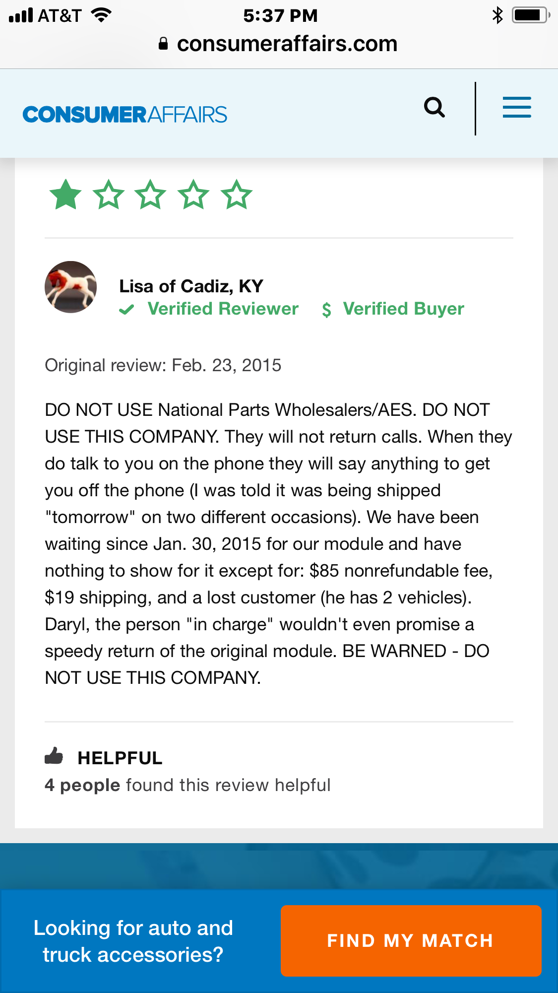

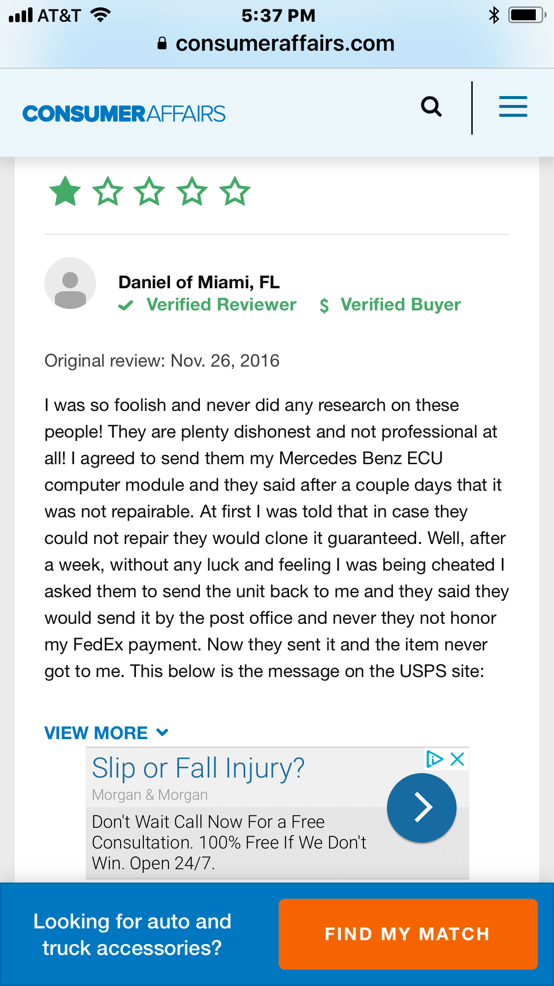

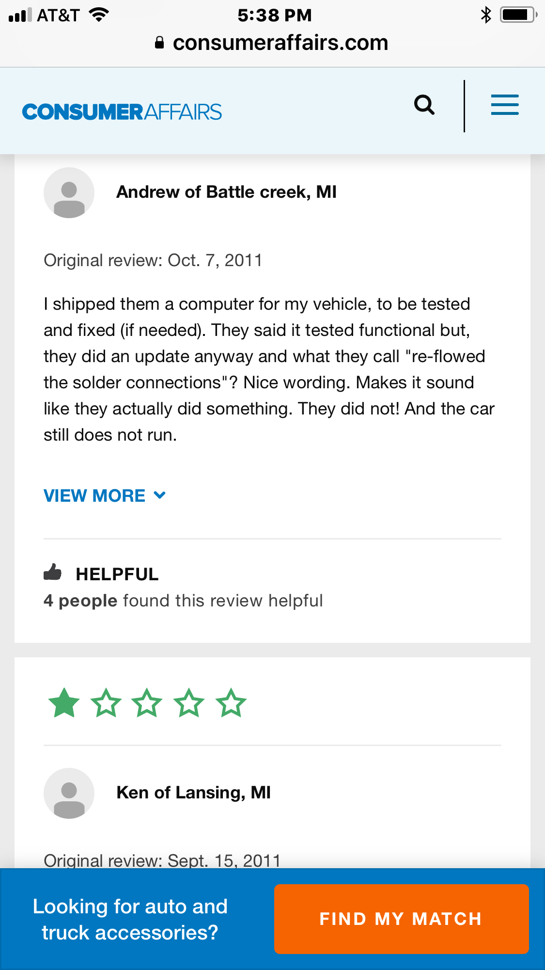

Hey guys, got a question for you all.
I have a 2002 xtype and the ECM failed so I get on the net and search out an ECM repair facility and “module experts came up, after some research I decided to contact them, made the agreement with Mark Davidson (salesman) to send in the ECM, two weeks go by and Mark contacts me and said the ECM is fried and I need a new one so I give him the go ahead to get one and program it to match my VIN , two more weeks go by and he contacted me saying I need to send in my cluster to get the final programming done (I’m getting a little angry now) so any way I send them my cluster and 9 days go by and mark asked why I didn’t send my key with it,( I said you never asked for it) he said he did and that sometimes people only hear what they want to hear (now I’m pissed) so last Thursday night I get on the net and search “module experts complaints” and oh boy, the things I found. (See attachment)
Tell me what y’all think and the actions I need to take.
