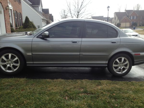

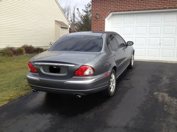

Some pics

Hey congrats on the purchase. Nice color! If the car was as described then you paid a "fair" price. Looks like the side indicators have been changed to clear from yellow. Hope you enjoy. Treat her right and she will love you long time!

Hmm, is it just me or are the front bumper blades lacking the US-mandatory lights while the rear ones have them?

The side molding on the drivers door looks like it's coming away from the door a bit, looks like maye a broken clip or two. Anyone know a good source for replacements? And does it just pop off?

As far as the trim, you should find the instructions for the removal and install in the Handbook and FTIS12 Manual that are mentioned in the "Stickys" at the top of this X-Type Forum page.
Another great source of info is to use the "Search" and then "Advanced" tab, also at the top of the page.
3M makes a pretty good 2-sided trim tape that might be the quickest, easiest, down-and-dirtiest solution. You might be able to just beg up a few inches of it from a local body-shop.
