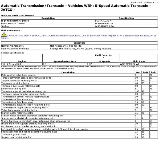

Yes, the X-Type Workshop Manual (Auto Transmission section) states the box is sealed for life and fluid replacement is unneccessary - except for instances of severe duty. In which case, fluid exchange is recommended every 30,000 miles.
See the attached extracted page from X-Type Workshop Manual;
