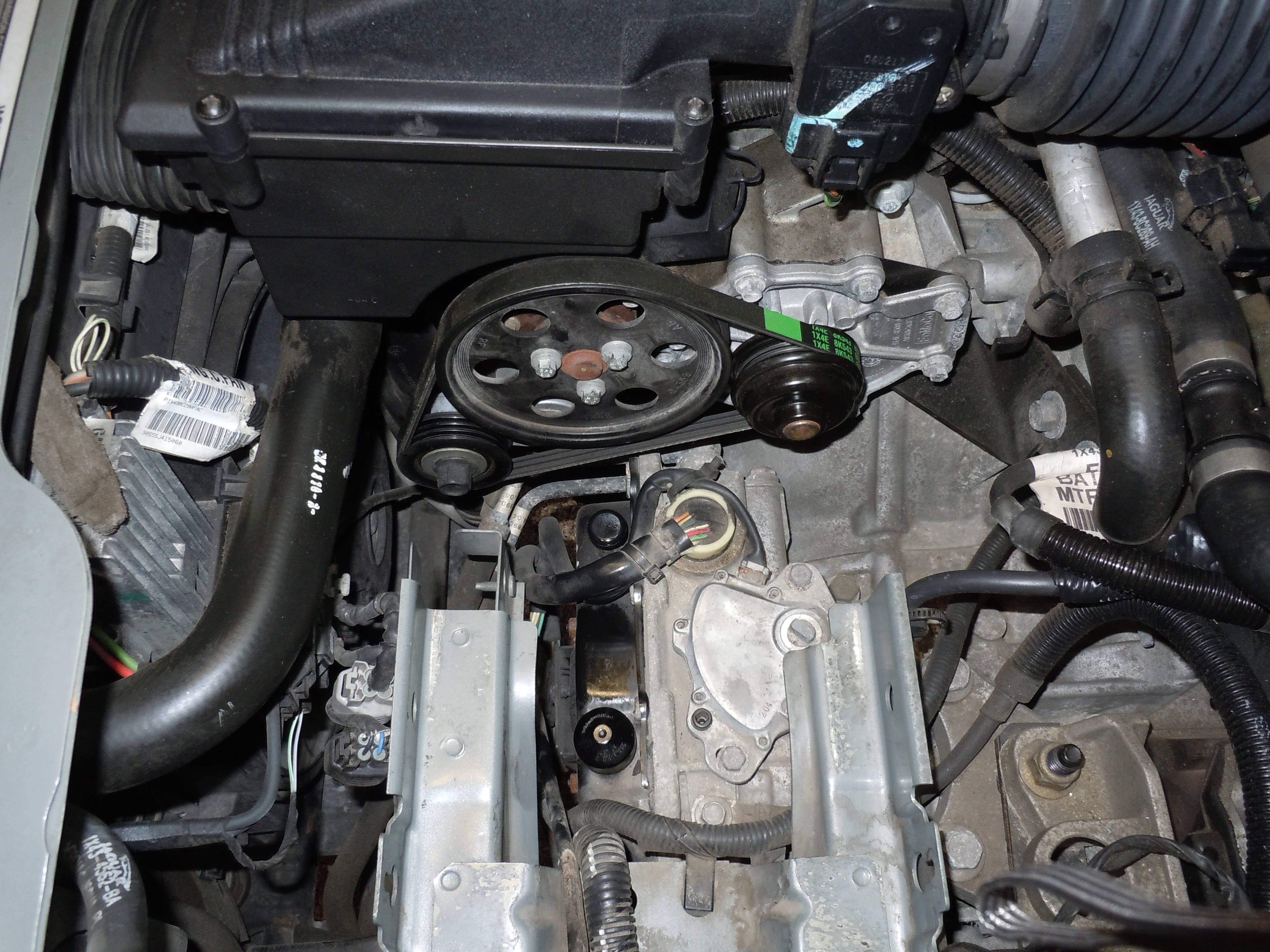

Good info on the drain plug. Am a newbie here - was looking today near the battery box for the fill port. Is is capped by a black rubber plug about 1" in diameter? Looks like moving the battery box slightly might give better access to it.
Yes.
Much easier to just remove the battery.
I still have not found a funnel that fits, i make my own

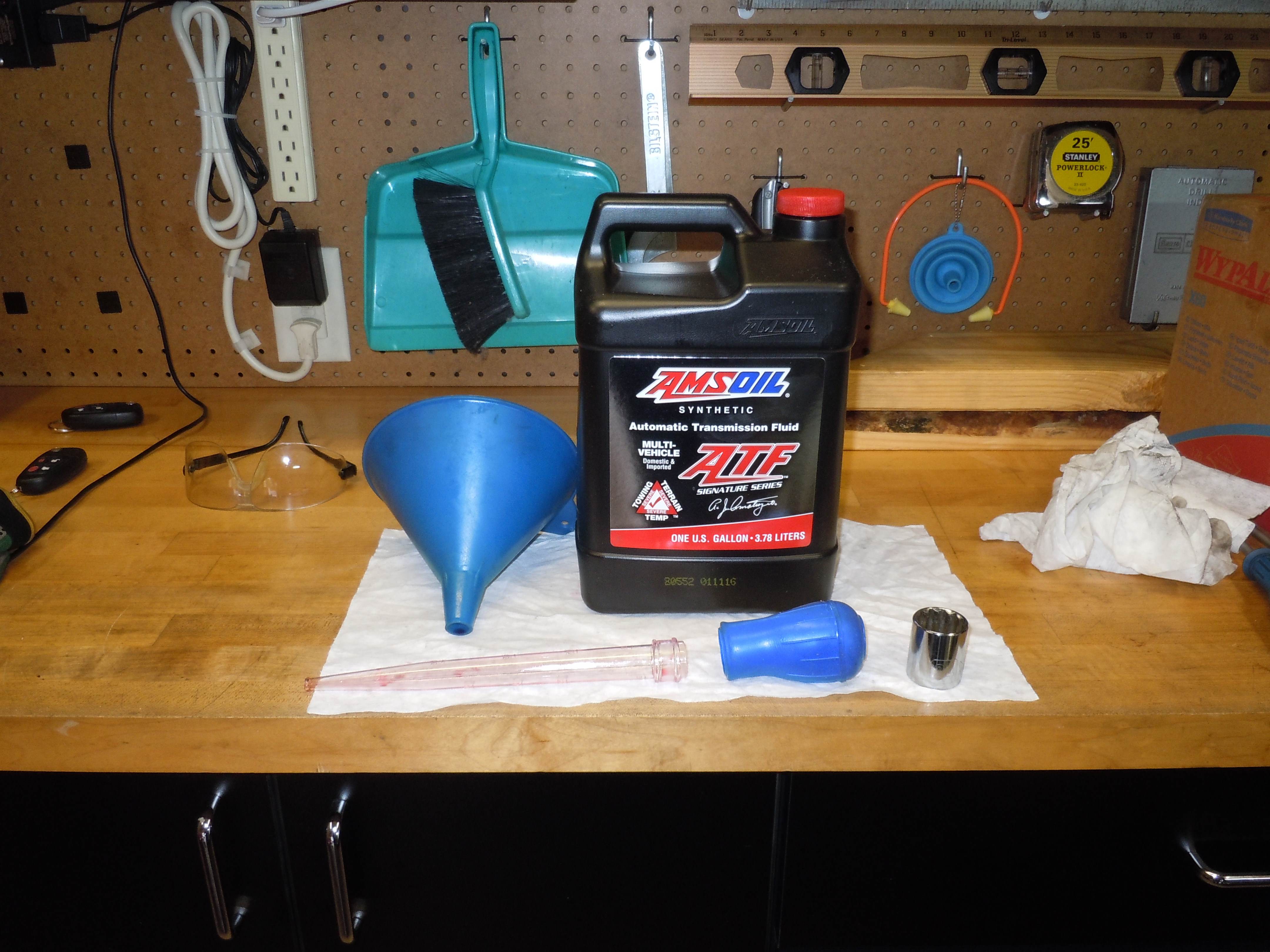

Here is what I did - went to Dollar store and bought turkey baster. Took the bulb off the clear plastic tube of baster. I put that narrow end into the fill hole of transmission after taking out rubber plug. Then into the larger opening of baster tube I inserted my standard long transmission fluid funnel. That worked perfect and I refilled Castrol Import fluid using that combination of funnel and tube from turkey baster

My (new to me) car has 105k miles. After studying the posts in this thread I tackled the ATF change. I removed the battery; doing so makes this service really easy, plus never hurts to give the battery terminals a little attention. The fill plug is the one nearest the water pump pulley. The larger one nearby is a vent plug. First drain gave me exactly 3L of very black thin fluid. I put in 3.5qts of fresh fluid then went for a short drive then returned for the second drain. Fluid drained second time was discolored, but now had some red color to it. This second drain/fill took me all of ten minutes because now I've got the steps down. It's not even necessary to raise the car. The turkey baster/funnel combo (thanks RobinGa) works because the fill port is pretty small. You can bin the rubber bulb as it's not needed. Use a 24mm socket for the drain plug. By the way, you can use the same fluid for the power steering system. I've evacuated the reservoir three or four times now as it's obviously never been touched.
