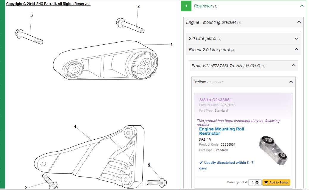

I believe the part you are looking for is the Roll Restrictor. I have attached a blow up from SNG Barratt a forum sponsor. You can go to their website and download for free an electronic version of the X-type parts catalog.
https://www.sngbarratt.com/us/#!/English/Downloads
