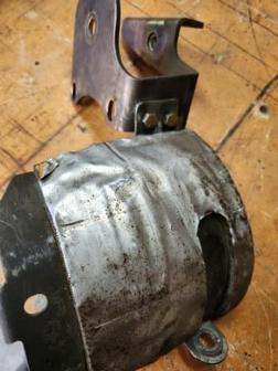

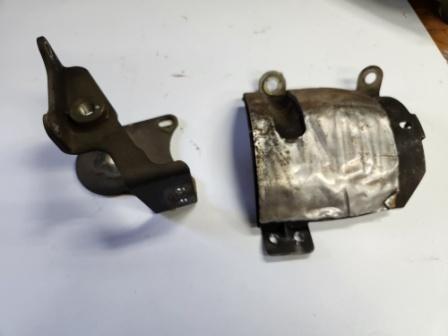

Modified anti roll bracket

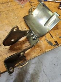

Nuts welded on....bolts fir from top

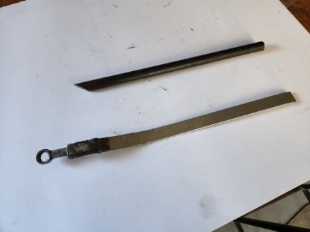

My Special tool and jamming bar.

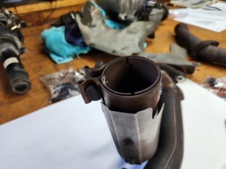

Reversed clamp on exhaust from rear cat.

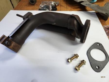

I had to cut the studs off the flange that attaches to the exhaust pipe....drilled out the studs, cut a new gasket with my last piece of exhaust gasket material I had...bolts will actually make fitting easier.
