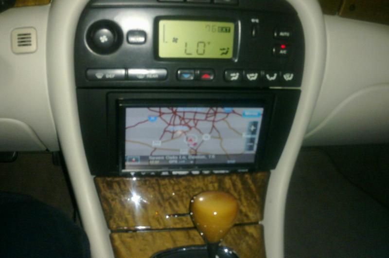

Originally Posted by mcduvall
mjlaris, do you happen to have any pics of yours in your car?
It's an Alpine INA-W900, with XM Radio, HD Radio, iPod, Nav, touch svreen, steering wheel controls, etc. See attached photo,
Mark
