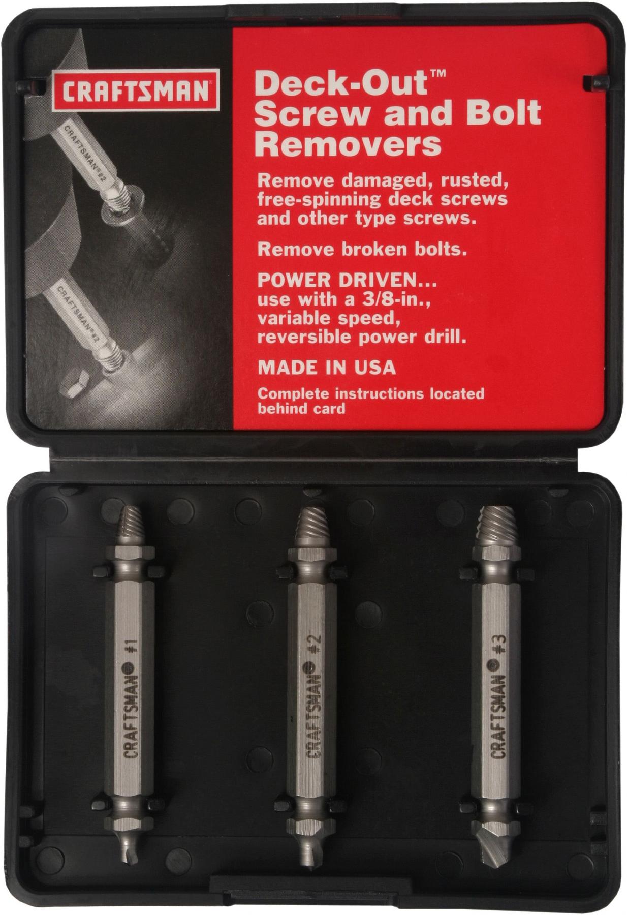

Taking that valve cover off is pretty simple, you're so far into it now I'd press on. Once you get the housing out (or if you can get to the broken bolt where it is now without removing the housing even better) if you get a screw extractor set it will make very simple work of taking that broken bolt right out in about 2 minutes using a regular drill (spinning backwards)

I pretty much gave up and put it back together this morning. Taking the valve cover off didn't look too hard but getting those two hoses off was a big headache and extracting the bolt looked pretty bleak now that I fricked it up last week drilling at it like a madman at an angle while it was still in the engine. So now my options are buy a new housing or buy a used housing. I am talking to a Jaguar repair shop, but won't be open til Monday. Wondering if I should just order a used housing now or wait til they look at it. The new housing and pump is about $300 which is not too bad but add labor and it's not going to be cheap.
