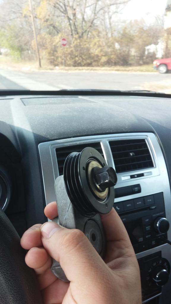

I was able to refuse the tensioner by just removing the bearing that was left of the pulley: Name:  20141101_170614_zps52b532ff.jpg
And replacing it with an Idler pulley from an 03 Toyota camry: Name:  20141103_095928_zps8fb67851.jpg
It works perfect! Already driven on it for 20 miles without issue and is a perfect size and fit to the belt. Was only 48 dollars at orileys. I hope this saves someone else from the days I've spent (and I literally mean days) trying to track down a replacement as there is no jaguar dealership here.

Nice work , good to know in a pinch.
