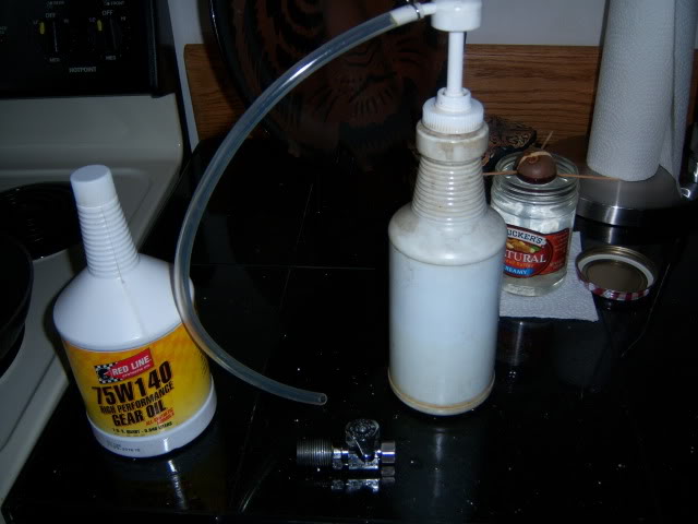

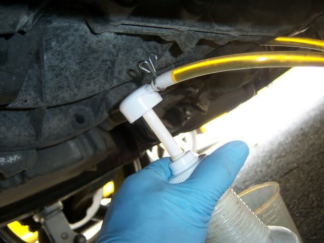

in my transfer case from day one i put in redline 75w 140
its been bullet proof since 2002
just my prefferance
