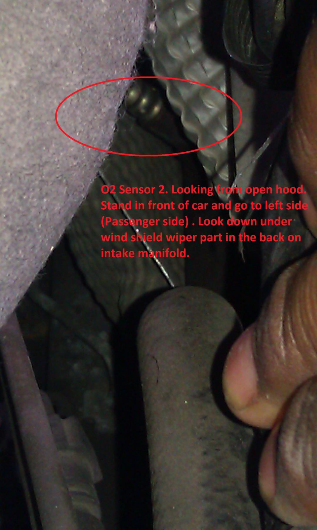

Thanks lol I took a bunch of pics so I will add em anyway. I am guessing 2 and 4 are downstream am I correct?

Post Just what I had before the diagram.
Maybe help some others out.

How do change out sensor 2? Cant reach from bottom do I go in by taking out intake manifold?
