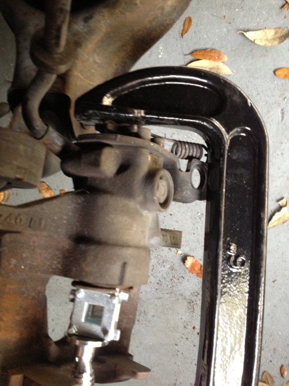

Rotors are easy. After you've removed the one screw and swung the caliper over, the rotor should come right off. You may need to give it a little persuasion with a FBH if it's seized on. Don't be scared to hit the rear hard. (thats what she said) It'll come off.
Clean the hub with some brake cleaner and a wire brush. And smear some anti-seize on the rear of the rotor.
The pads are straight forward. After you've taken the screw out and swung the caliper you'll see how the pads come out. Some more anti-seize to stop any rattling and it's the same job in reverse.
The Pistons.
You will need to get the pistons back into the caliper before you can get the pads in. This is where most people have problems. The front piston should just go in using a wrench. The rear pistons need turning in as they are the emergency brake. There are many posts here telling you how to do this. There is a cheap tool at most auto stores. It's a little cube. You clamp it on with a c-clamp and using a screw driver turn the piston in. Both sides turn to the front, So the left side turns anti-clockwise and the right clockwise.
Here's a picture I took when I was doing my brakes last year.
BTW, when I did mine it was the first time I'd ever changed rotors, and only the second time I'd changed pads. Look at the many posts on here and you'll do fine.

Fronts are straight forward, rears follow flyrr100 instructions. I suggest you rent or buy the tool needed at your local parts store. I tried using a c-clamp and some locking pliers to turn the piston in myself and damaged the rubber seal in the caliper ....expensive mistake....
