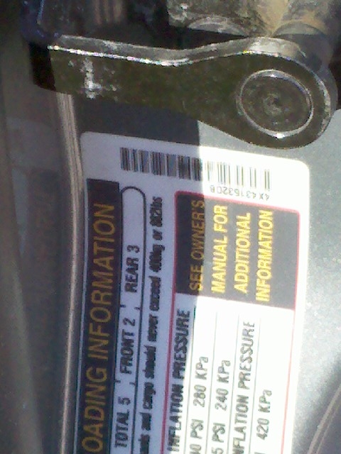

The sticker on my car is on the driver's side post, just below the latch. I've enclosed a picture of it. Not sure if it's always been located there through the model years. Or maybe your car has been painted there at one time and it was never replaced.
From the sound of your issue it doesn't sound like it's tire pressure as much as something in the suspension. You should not have that harsh of a ride on stock tires of that size. Mine have a 40 aspect ratio and I have the sport model and although the ride is somewhat firm it is far from being jarring in any way and we don't have the best roads here in Wisconsin.
