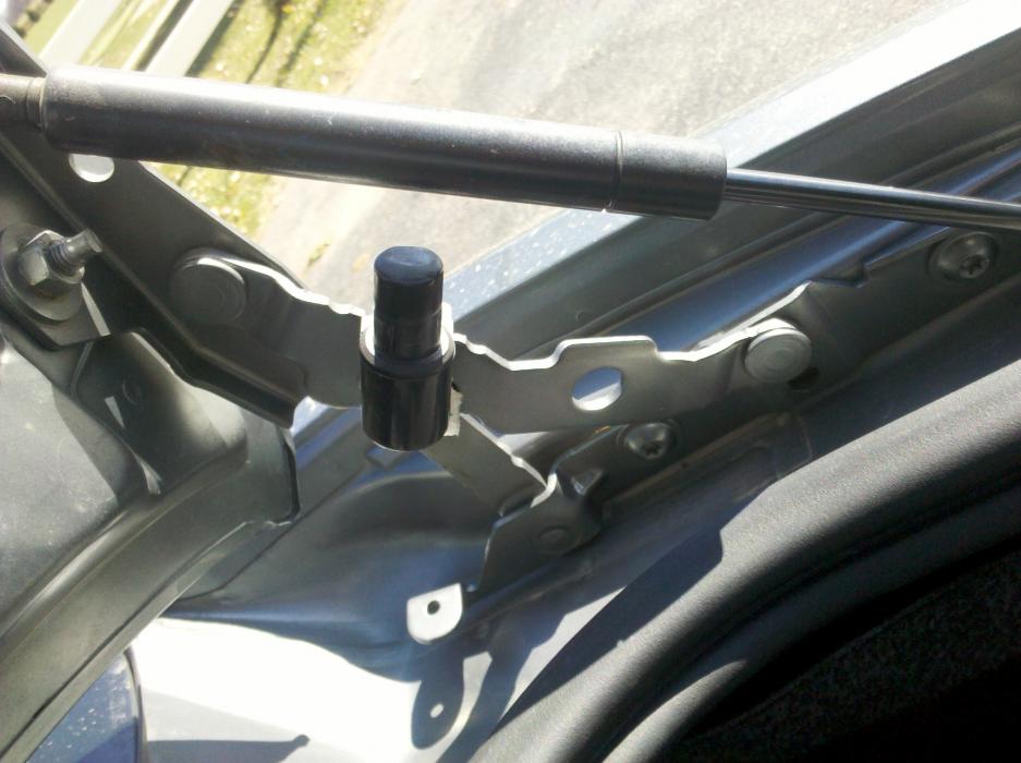

Same thing happened to me. If you open the trunk on the right hinge there is a plastic button. Mine was a little loose. Just shimmed it up a little higher with a piece of thin cardboard. That took care of it. When it gets loose it sits just low enough so the switch doesn't trip. You could also maybe put a sticker n top of the switch to raise it up a bit. I agree, it was annoying.

I looked on the hinge and I don't see any buttons. The two black spring things have both broken off. But I don't see how they would indicate that the boot is open.

There is one of these buttons on each hinge. Here's a picture of what it looks like. If you do not have these that probably explains why you are getting the "boot open" message.

Those are spring loaded actuators. They
Help pop the boot open and are not
electrical switches. The problem is in
the latch an not with the actuators.
