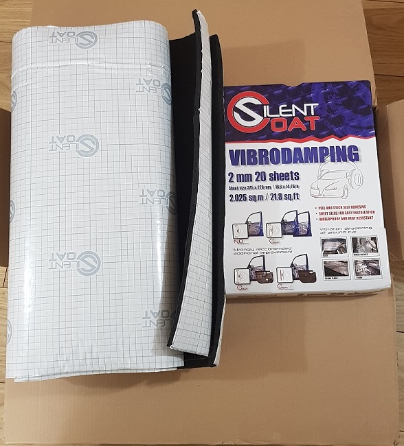

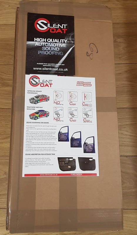

Couldn't write the script, could you?
Parcel arrived today, of course yesterday would've just been hunky dory as I had the time and could've had this installed...…

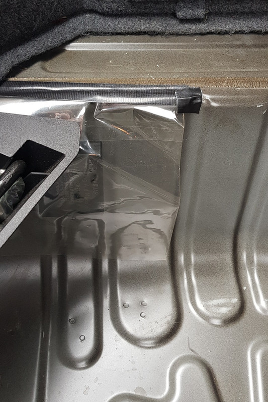

A point of note from when Connor had a leak in the boot due to a bad seal, as is the case this of course killed the rear parking module resulting in a few £££ to replace. The seal / leak of course is long fixed, but as a belts n braces type measure I've added a plastic cover of sorts. This is above the module so that in the event of A N other leaks it will not be destroyed so easily...

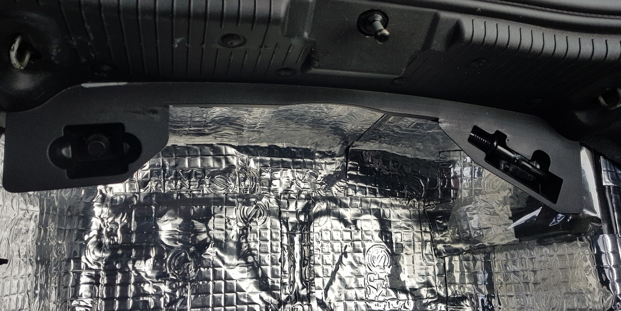

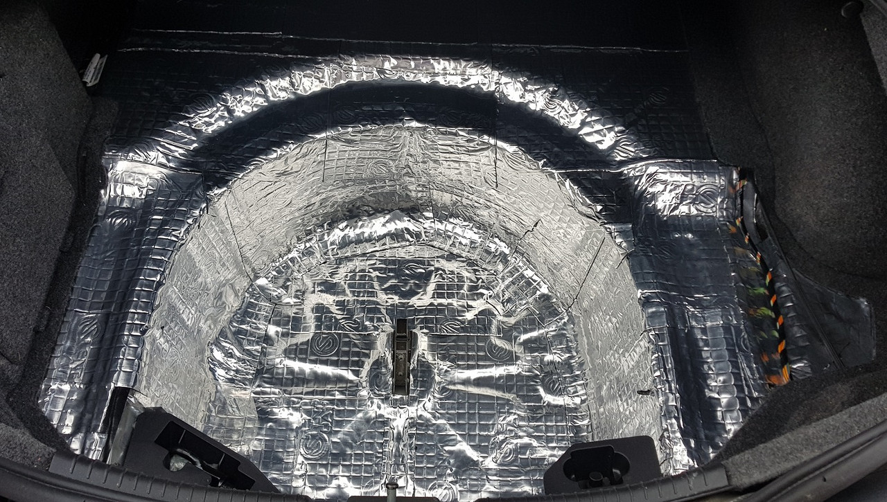

I added the 2mm Silentcoat vibro damping material, this gives the tinny wheel well area some bulk / mass and instantly deadens any sounds entering that area. it's very pliable and can easily be cut to any size, great adhesive properties, sticks very well, here's the entire boot area covered

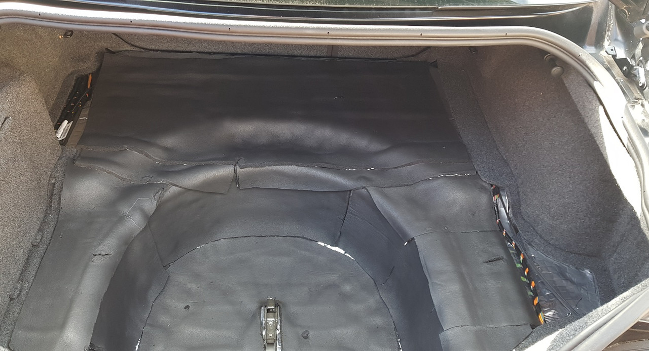

Then for good measure the closed cell foam on top, this is 10mm thick with a self adhesive backing and again sticks very well. Any sounds that do get through are absorbed and lessened even more
I took her for a run afterwards and definitely seems quieter, but Mrs C's ears will check and advise me later no doubt.
