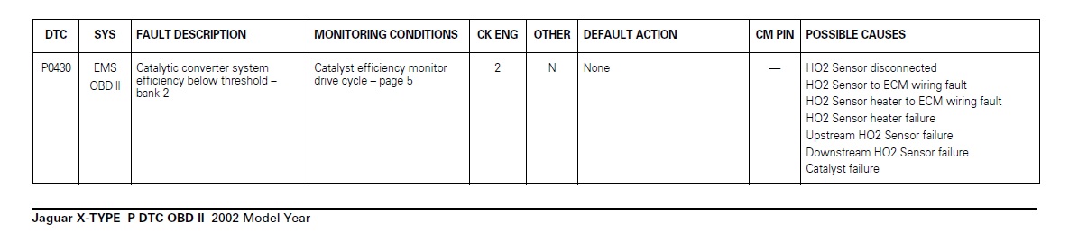

Welcome to the essexgarage,
Here is the extract from the Jaguar DTC listing for P0430:
See 'Possible Causes' in the right hand column.
