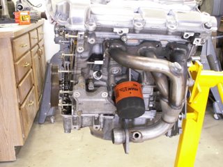

Thanks Thermo, points well taken. The picture below is from Steve Hannes JAG Project blog. He removed the oil cooler with coolant hoses running in and out of the oil filter assy. and replaced with a larger oil filter. He says a larger oil filter has some cooling effect on the oil, and the de-clutter of removing the extra hoses and oil cooler assy. creates more air flow in the engine bay. I don't think he finished this project b/c he never says what he ended up doing about the cats. Maybe they will come after the headers. The headers are off a Mazda that came with a Duratec engine. If you haven't yet, this is a good read.
Jaguar Motor Project: Motor Project # 15 - Oil Filtering

Here's the modified 3.0 Duratec compared to stock (Steve Hannes blog):
Stock but it doesn't have the advantage of being all clean. This pic is from 310Jag's Engine removal thread. Everyone should give 310 a JAG Hi-five for breaking down the build of the JAG Duratec V6, in pictures and words in this thread: https://www.jaguarforums.com/forum/x...ead-faq-11225/
This is what we have. But we could have the above pic with headers and a fat oil filter. Although, I never use a Fram oil filter because they clog up.
Attached Thumbnails X-Type Exhaust Upgrade-newassy1_zpsd2bcb04a.jpg   X-Type Exhaust Upgrade-stockfordduratec3l-exhaustmanifold_zps4f9dc05b.jpg
